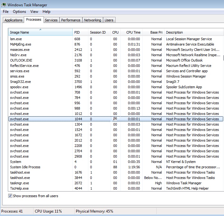

    You can notice the PID column of the afflicted svchost.exe Service in Task Manager, right click the afflicted Process and choose Services (Process ID PID 1044 is running amok in this bad example):

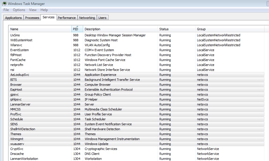

    Then in the Services Tab, click the PID column to sort by PID and you can see all the important Windows Services that are running under that svchost.exe process.
    if you see wuauserv.exe (Windows Automatic Update Service) running under the afflicted svcshost PID the Windows Update Service is likely the problem so you need to fix it:
