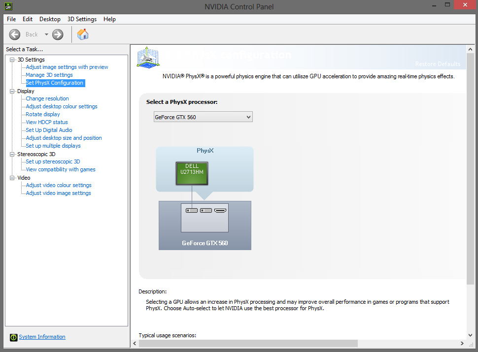

    Hi!
    I think I found a fix for this problem. Open Nvidia Control Panel and in the Set PhysX Configuration section set PhysX Processor from Auto-Select to GeForce GTX 560. It worked for me and already week without crashes :) Don`t know how to technicaly explain this, but it worked for me :)
