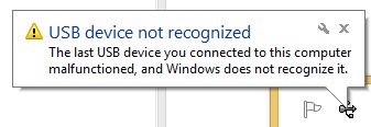

    2014-01-21T16:10:14+00:00
    1.      Yes I have checked different USB ports.
    1.      Attached image.
    3.      Attached image.

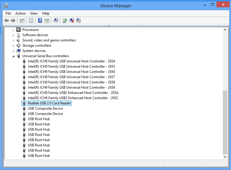

    I had this same problem and it took me over a week to solve the problem. For reference, my laptop is a Toshiba Satellite L305-S5947. I bought it in 2009 and just recently upgraded it to Windows 8.
    #1)  Make sure that your SD card is not in the locked position. (Google to check this).
    #2) Download the card reader driver from Toshiba Support. Type in your laptop model. I downloaded Realtek USB card reader. Looks like this:
    I downloaded it and still no recognition when I put my SD card in the slot. I left it alone for a week.
    #3) [MY SOLUTION]: If you've done a Windows 8 or 8.1 upgrade, your computer may not be allowing smart cards to be read. Go to Control Panel > Administrative Tools > Services
    Scroll down to Smart Card and make sure that it is not disabled. If it is, change startup type to "Automatic" and click apply. I then went back to Smart Card and pressed the "Start" option.
    (I found this clue here: http://www.bleepingcomputer.com/forums/t/441781/sd-card-reader-gone/).
    Voila, my computer recognized the SD card. For me, it was neither a hardware or driver problem. It was a disabled feature.
