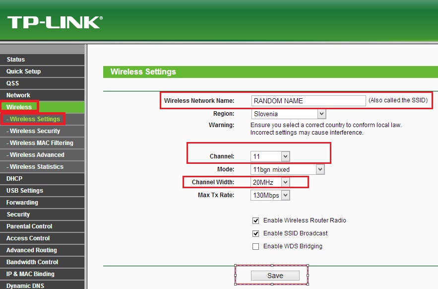

    I use Asus Ultrabook UX51VZ with Windows 8.1 and TP-LINK TL-WR1043ND WiFi router and had the same issue when I bought this new router. All devices in house (3x iphone, 1x ipad and 3x laptop) worked perfectly, just my device had a problem. Well to honest, mine also worked from time to time, but couldn't tell when is going to stop working. Anyway it was f.... annoying!
    I spent more than 10 hours solving this issue and nothing helped. I read all the forums, threats, blogs possible to find a solution inside my OS, but I was still trapped in to "No internet access" or "Limited connectivity" problems. When I used the wired connection internet worked, but not through WiFi.
    Than I decided to try find a solution on my WiFi router. I updated the firmware and it didn't help, so I decided to call TP-LINK customer service support. They walked me through the steps what to do and now it works. So here is what I've done:
    1. Connect to the router http://192.168.1.1/  (use the LAN cable to connect).
    2. Type the username and password in the login page. The default username and password are both admin in lowercase.
    3. On the left hand choose WIRELESS/WIRELESS SETTINGS  and change the following:
    a.) Define a new Wireless Network name to a new one
    b.) Channel 11
    c.) Channel Width to 20 MHz
    d.) click SAVE

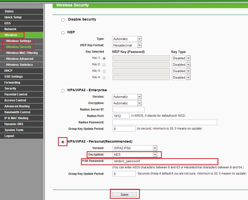

    1. On the left hand choose choose WIRELESS/WIRELESS SECURITY  and change the following:
    a.) Encryption to AES
    ****b.) Define a new PSK Password to a new one
    c.) click SAVE

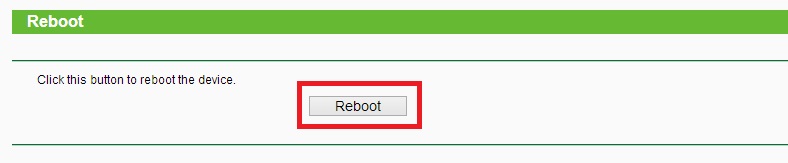

    1. On the left hand side choose SYSTEM TOOLS/REBOOT
    1. Connect you your new WiFi like a charm.
