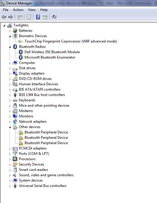

    Well. I managed to get the two drivers, probably not the original ones, back (same name and whatnot) with the vista install...and it works for connecting devices...even file transfer. They disappeared with the Toshiba install, which I noticed when it said to plug in the blue tooth device and press okay to continue...which confused me because its internal...not a plugin. Anyways. Yeah. Got the vista ones in place of what I had. Now with my headset that I was trying to get to work, it shows the devices in the audio devices...but they don't work. I shall put a few photos here of what I am talking about. I know the drivers work...I just can't seem to get the audio part of it to work, which I know I need some other audio profile supporting stack for... The pictures and descriptions (pictures were taken with Snipping Tool:
    Above are my drivers as of now.

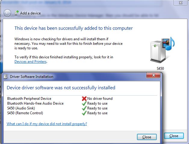

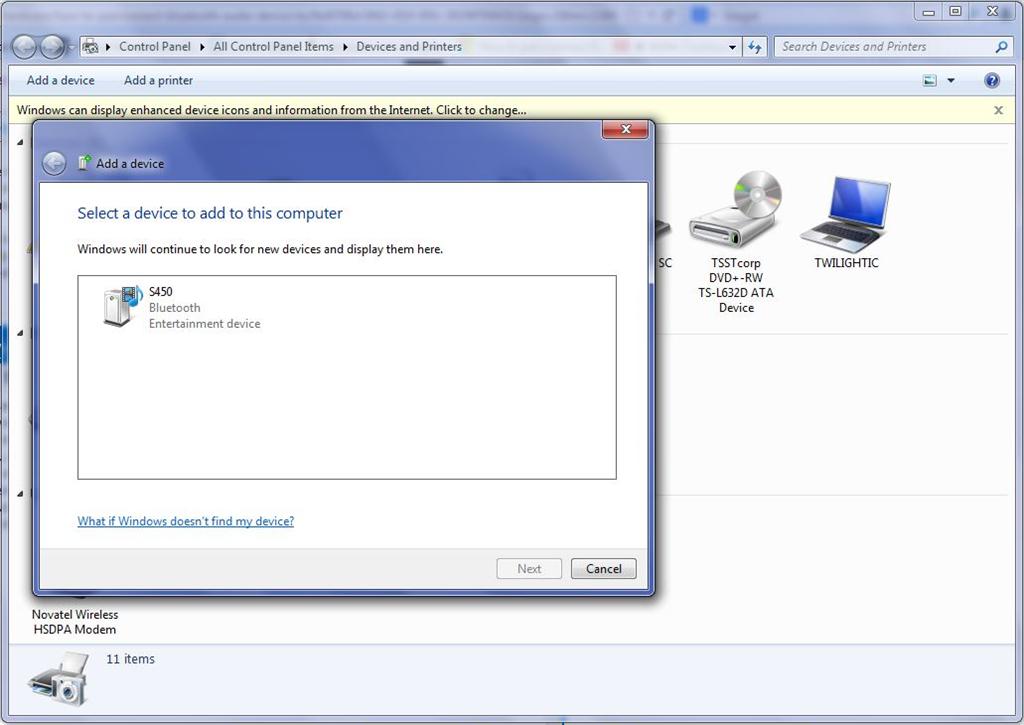

    These are what it tries to and installs when I add the headset. (Which is completely bluetooth. No wires or usb plug. Also my headset stays in pairing mode, like it doesn't connect with the computer...but the computer seems to think its connected.

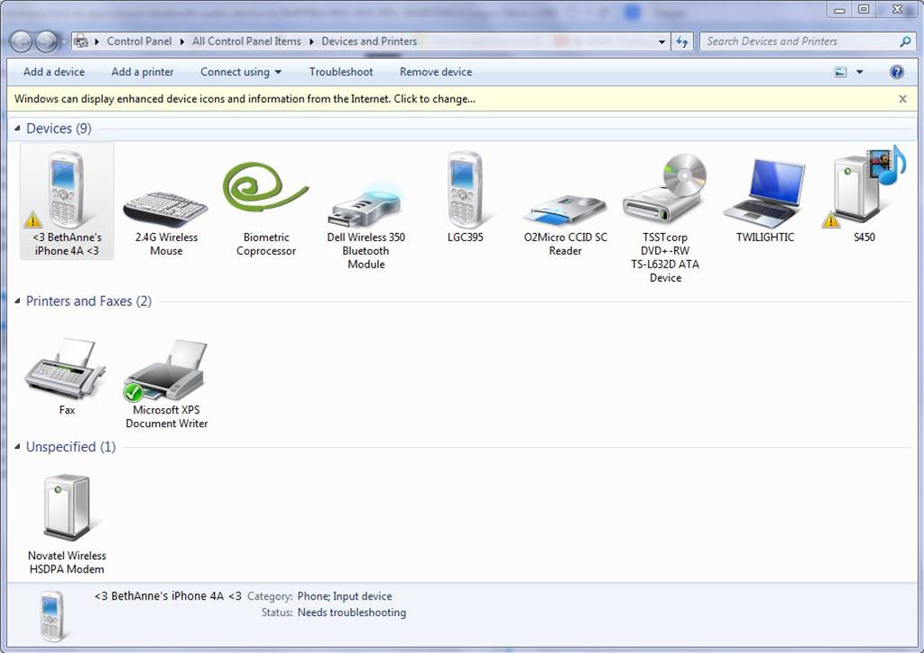

    There is the headset after its finished. S450.

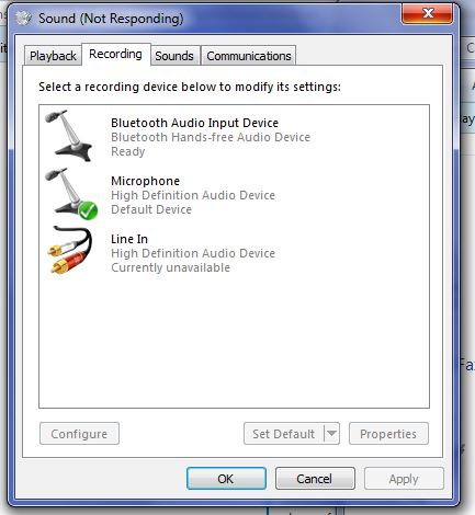

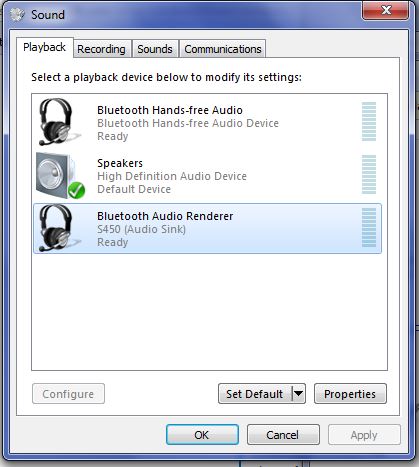

    Both of the Bluetooth Audio devices in the picture above are from the headset, and I'm not sure why... I've tried every possible option on trying to get them to work from Test, Default Device, and even disabling my speakers. Audio doesn't go through.
    And here is the mic side of things. Same thing as headset. It doesn't work and even hangs on the screen (as you can see it says not responding) only while I have the device on my bluetooth devices and such.

    Your explanation of the problem is good and the pictures are very helpful, but it's hard for me to say what's going on between your PC and your Bluetooth peripheral.
    According to the Device Manager, you have Bluetooth Radio drivers installed.  That's good.  But it's impossible for me to know which capabilities (Bluetooth protocols) that the driver software stack supports and which ones your Bluetooth peripheral requires (like AVRCP).
    http://en.wikipedia.org/wiki/Bluetooth#Bluetooth_protocol_stack
    According to the Driver Installation report you posted, it seems that at least 3 of the needed protocols installed properly.  I'm not sure what the "Bluetooth Peripheral Device" failure means.  It could be driver specific to your peripheral. Maybe something downloadable from your peripheral makers?  Or it could be an insufficiency in your Bluetooth driver stack.
    The picture of the Device Manager seems to indicate that the drivers for the peripheral (not the drivers for the internal Bluetooth radio) did not install properly.  I'm not sure if any of that got fixed later when the green check marks appeared upon driver installation for your peripheral.  Those yellow exclamation points happen (I think) when either your Bluetooth driver stack doesn't support the needed protocols or the devices specific driver hasn't been installed.  I can't say which.
    I don't know which capabilities your Bluetooth peripheral has (I assume it's just a stereo headset without a microphone).  If the driver is installed properly then you may need to set the default under the Sound/Playback tab to one of the Bluetooth options.  I'm pretty sure it won't work as you've shown with the sound set to come out of the "Speakers".  (You'd have to set it back to speakers when not using the Bluetooth peripheral device).  Some Bluetooth stacks (like the Broadcom Widcomm stack) have an interface that pops up when you connect a Bluetooth device connects, and that interface eliminates the need to change the sound output settings in the Windows Control Panel (like the ones you've pictured above).  That's another reason why it's good to have a new, well-supported Bluetooth radio and driver stack-- and so it may be worth spending a dollar or more on a newer Bluetooth radio for you PC.
