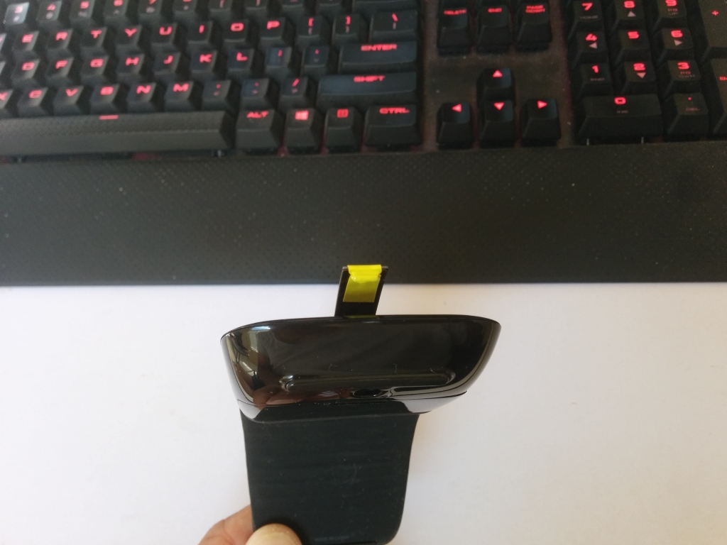

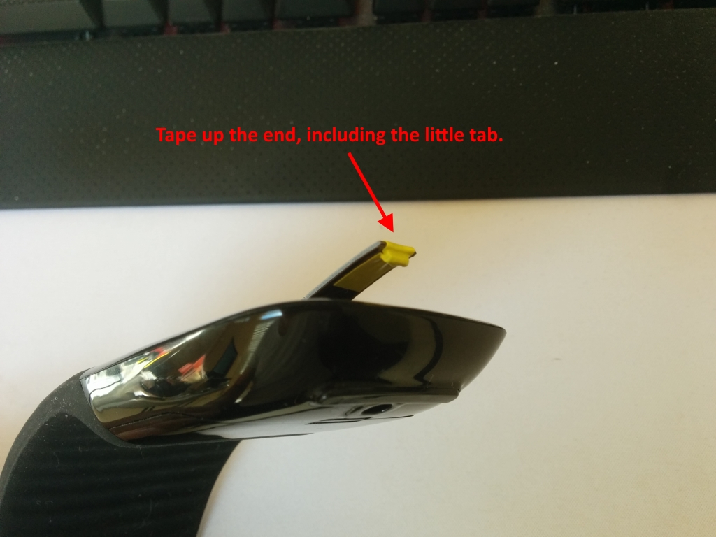

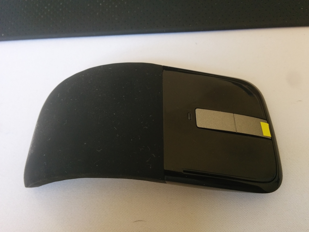

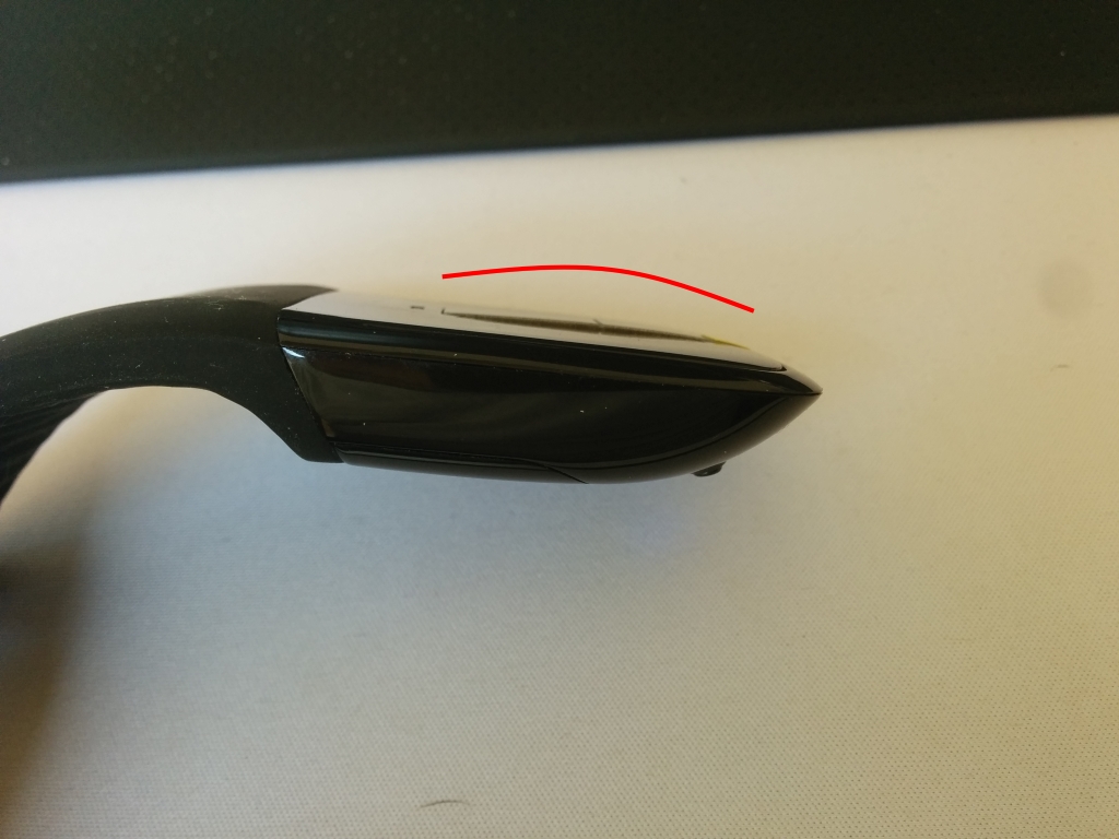

    I have made further modifications to my mouse.  I used a little bit of electrical tape and tape up the end of the scroll sensor and that seems to make it work 100% of the time so far (see attached picture).  My electrical tape just so happens to be yellow, but you can use regular black tape.
    Another note, if after doing this and it seems like your scroll is working (use File Explorer and just scroll up and down to test) but your vibration motor is not working, you might have a loose motor connection.  So what I did with that was to take it apart, there are 2 very small screws inside the battery compartment.  Remove the sticker to get access to the screws, remove the screws then use your finger nail or a credit card to pry the top button panel off.  Underneath there you will see the black and red wire attached to a metal rectangular motor.  Unplug it, then use a little cloth pin and just poke at the little metal connection.  Basically, what you are doing is squeezing the little metal tab so that is makes a better connection.  Put everything back and see if that works for you.
