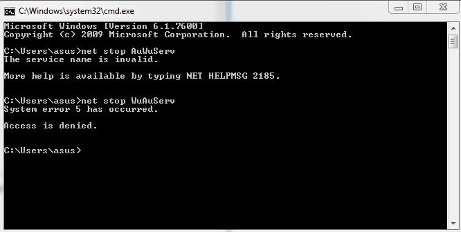

    hey i tried both above steps. but its Saying
    System Error 5 is Occured
    Access Denied
    Please Help me with this..

    I had the same problem and fianally found a solution, check if it works for you too
    Solve HRESULT: 0xc8000222 when installing NFW4
    1/ Start. Run. Type "cmd"
    2/ Type "net stop WuAuServ" ( stop Windows Update). Then close
    3/ Start. Run. Type "%windir%"
    4/ Find and Rename folder "SoftwareDistribution" ---> "SDold".
    5/ Do step 1/ again
    6/ Type "net start WuAuServ" ( restart Windows Update).
    7/ Install NFW4 again.
