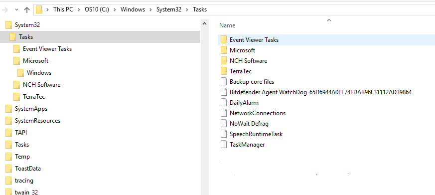

    As you have already discovered, the folder containing Tasks for Task scheduler is at C:\Windows\System32\Tasks [which can also be addressed as %SystemRoot%\System32\Tasks].

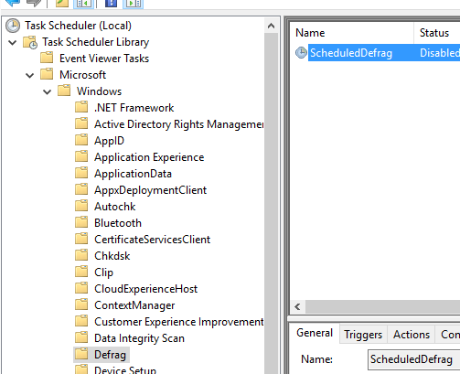

    1  Open Task scheduler, count the errors.  Then click on each task in the Task scheduler library until the number of errors is reached, noting the failures [including their location in the folder hierarchy] as you go.  Close Task scheduler when you have finished.

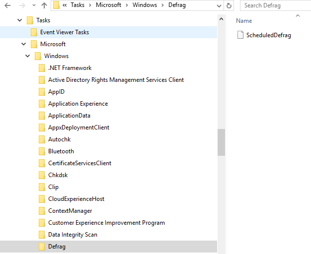

    2.2  Open File explorer, go to C:\Windows\System32\Tasks.  Use the notes you have just made to get to the corresponding point in the folder hierarchy.  Delete the task [noting kirkaholic's advice about any folder containing multiple entries].

    4  Investigate the deleted Tasks.  They must have existed for some purpose and you might need to recreate them.  In the example I used in my diagrams, the Defrag task can be recreated by running Defragmenter [%windir%\system32\dfrgui.exe] then setting up scheduled defragmentation again.

    • Make Snipping tool diagrams to show those sections of the folder hierarchy within File explorer so that the absence of a corresponding folder can be seen [because that is what you are reporting, if you understand you correctly].
