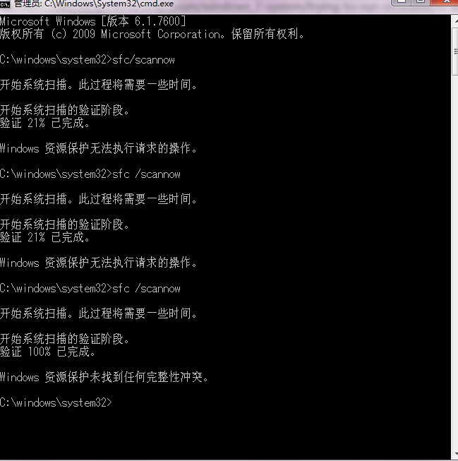

    2015-06-18T20:59:24+00:00
    Your command is wrong after the prompt
    there has to be  a space after sfc      not sfc/scannow
    C:\windows\system32>sfc /scannow
    2015-06-21T23:25:15+00:00
    Look closely, the space is there as indeed it must be for the command to work. There is also a less obvious but equally necessary space between the back slash and the forward slash in the middle of the command, e.g., d:[SPACE]/. I mention THAT one because even as it is shown it isn't obvious to me that it's there but it has to be to run. Syntax is indeed that important. The main point of the exercise is that this command is roughly analogous to the Windows XP days when one ran sfc /scannow using the installation disk,and it is necessary to refer to the cd/rom drive rather than the system drive to run the Windows 7 version. In Windows 7 the routine sfc /scannow command uses the winsxs files instead of the installation disk as the reference files. The windows 7 command which runs with the installation disk is only really necessary if the routine command will not run. Does that help?

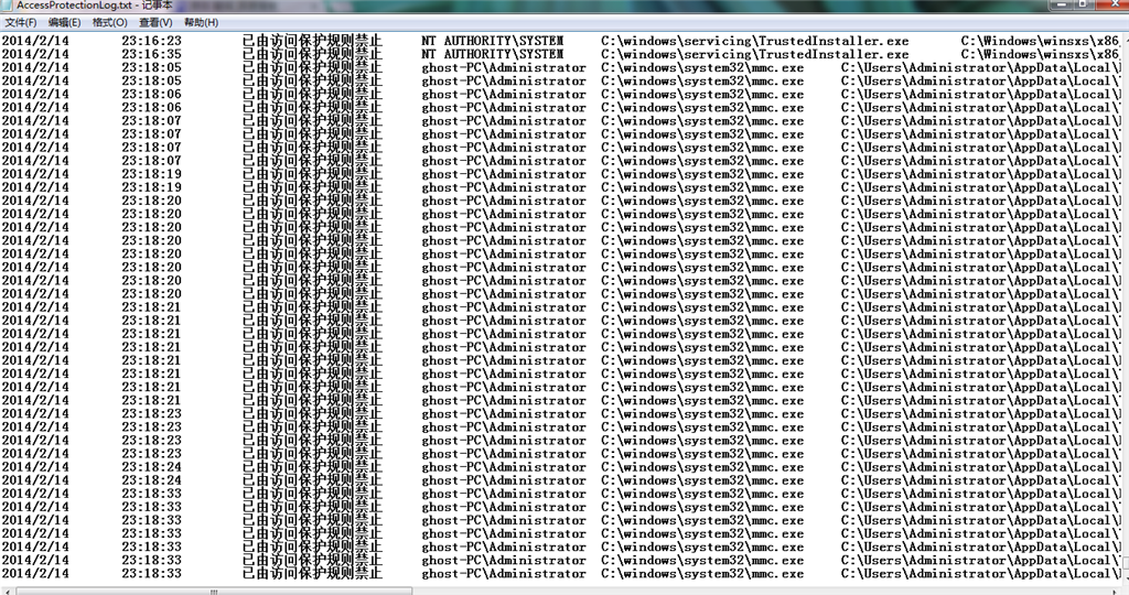

    2015-08-07T14:26:52+00:00
    This was the key for me. Owning a Dell PC with McAfee preinstalled.
    removal tool here->
    https://service.mcafee.com/FAQDocument.aspx?id=TS101331
