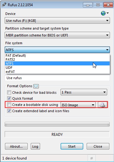

    Download and use rufus from this link:
    https://rufus.akeo.ie/
    rufus installs nothing and you will be done in just a few clicks without "trying" things.
    If you are not using an ISO to create a bootable USB leave the "Create a bootable disk using" box unchecked and it will just format the USB:
