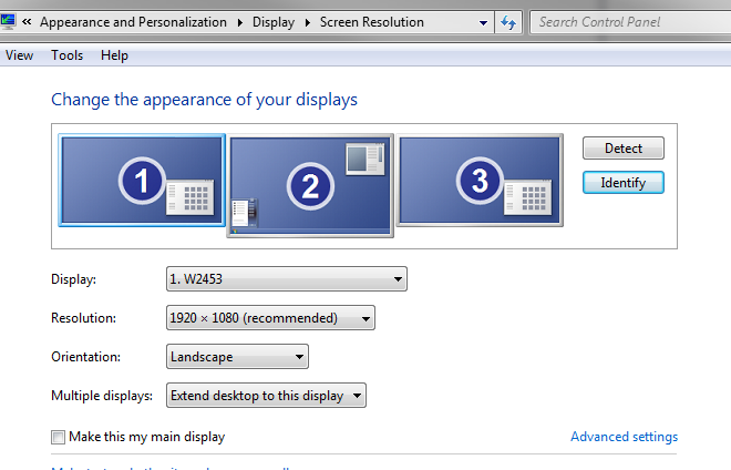

    Update: A couple of weeks ago I did some surgery on my machine and only had one monitor connected. Upon going back to a tri-monitor configuration, this problem came back again. I did *mostly* the same scenario as I did before to fix it, a couple of times, but it didn't work. I connected my primary (center) monitor first (the NEC), then my left and right monitors and re-positioned them in Appearance->Display->Screen Resolution, and the monitor identities were ordered 2->1->3 or 3->1->2.
    I read my first post again, and realized the order I originally listed to connect the monitors was LG->NEC->Dell. This is how I have my monitors positioned on my desktop as well.
    So I ran the exact scenario as I originally listed: connect LG->NEC->Dell. After being re-positioned in Appearance->Display->Screen Resolution, monitor identities are in the order 1->2->3 from left to right. Then delete the first two registry entries, and problem solved again.
    But is the order 1->2->3 of the monitors in Windows the key? I'm not sure. One other possibility I'm considering is the connection type: the LG is HDMI, while the other two are DVI. Perhaps HDMI needs first dibs in the registry? Unlikely, since HDMI is just a different implementation of DVI, but weirder things have happened. Maybe someday if I hit this problem again, I'll investigate further.
