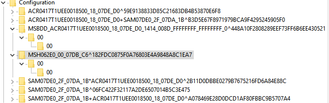

    Same for me. I do not have the option of a "simulated" screen in my registry on Win10.
    Heres how it looks like for me: http://i.gyazo.com/5b273dec9fcbc0460d784a9f9d651c2f.png
    I assume that ACR is my Acer screen and SAM is my Samsung TV, the resolutions fit them as well.
    Both MS monitors though are on 1024x768, so these might be the simulated ones I think?
    I don't know if that might cause heavy issues if I just try and still I don't know what "Stride" means, do I have to change that as well or just the resolution itself?
