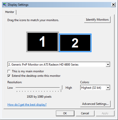

    Start by setting the Monitor that you want to rotate so that it is the Primary Monitor (even if you don't want it to be primary you will have to do this temporarily).
    Set the Primary Monitor to the one you want to rotate like this:
    Personalise>Display Settings (get to Personalise via Control panel or click on desktop and choose Personalise).
    To set the secondary monitor to Primary, click on its image.  Then Check ‘this is my main monitor’ (it is the UNCHECKED item shown below) and then Click Apply

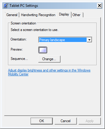

    Then go to the Tablet Control
    This can only be located on Control Panel.  Double Click it to start it.
    Now set the rotation of whichever Primary monitor is now chosen.  Experiment with the rotations by applying them.  E.g. to Landscape, as shown below where the Tablet>Display Settings panel is in use.  When you are happy with the rotation that you have applied, you can restore the normal choice of Primary Monitor, if you wish.
    Don’t
    If, after you have used the Tablet settings you still have a Personalise display open it will show the wrong rotation for your screen because it does not update when you rotate the screen.  Cancel this screen.  DON’T click OK;  all your work will be undone and the old incorrect settings will be restored.
