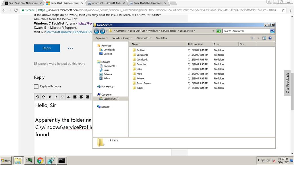

    2017-08-26T14:09:27+00:00
    Hello, Sir
    Apparently the folder named "AppData" in location of C:\windows\serviceProfiles\LocalService\ could not be found. Here's a photo of proof, I did every options you could think of like going to option and show hidden files or just execute the location or search it.
    Please reply asap or email me asap.
    Thank you
