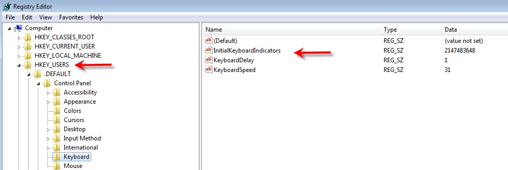

How do you edit InitialKeyboardIndicators in the registry editor so num lock is on at start-up? One instruction I read said to change the value to 2.  The number that is already present is 2147483648 which I have no idea what it stands for!  Can anyone help me out here? Thanks

I haven't read through every reply, but just in case there has not been an answer for this, here is what you do.
By default, NumLock, CapsLock, and ScrollLock are set to off on power up in WindowsXP.  If you want to modify this to allow one or all of them to be on by default at power up, follow the below instructions.
  1. Click Start
  2. Click Run
  3. Type RegEdit
  4. Expand to HKEY_Users
  5. Expand .Default
  6. Expand Control Panel
  7. Expand Keyboard
  8. Find sting value InitialKeyboadIndicators. (By default this will be set to '0' which means Num Lock, Scroll Lock, and Caps Lock are all turned off.)
  9. Double click the "InitialKeyboardIndicators" string value and make the following changes.
  • 0 - Turns off Num Lock, Caps Lock, and Scroll Lock
  • 1 - Turns on Caps Lock
  • 2 - Turns on Num Lock
  • 3 - Turns on Caps Lock and Num Lock
  • 4 - Turns on Scroll Lock
  • 5 - Turns on Caps Lock and Scroll Lock
  • 6 - Turns on Num Lock and Scroll Lock
  • 7 - Turns on Caps Lock, Num Lock, and Scroll Lock
Exit the Registry. When you restart, the new setting will take effect

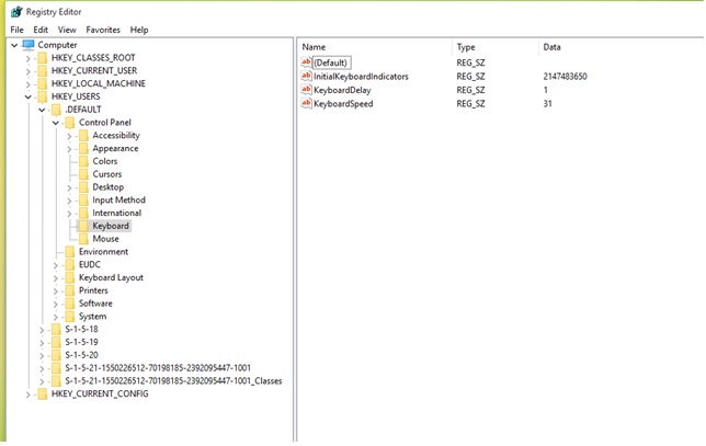

    2015-09-30T17:15:27+00:00
    thank you. I appreciate your work and time you spent with this article.
    Also I agree that it shouldn't be 9 pages long discussion.
    BUT...
    my registers :

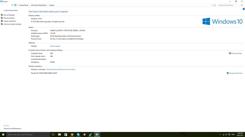

    my system:
    I believe I have everything you said it should be...
    I have tried to put there  .....50 value and also just 2 value.... folowing always proper shut down and start PC. (not just RESTART)
    In BIOS, I have NUM Lock ON,
    In BIOS there is no option for FAST START   (as was also one of solution of this problem posted by someone)
    My LED blinks 2x after PC start  (one very fast, then while loading windows (probably) little bit longer)
    But when appears login page, the Num Lock is OFF.
    When I just restart the PC then I agree the state of Num Lock is ON.
