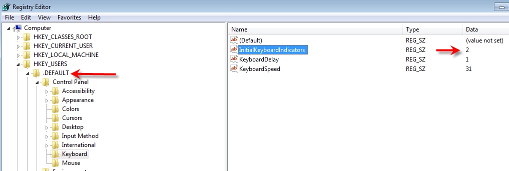

I haven't read through every reply, but just in case there has not been an answer for this, here is what you do.
By default, NumLock, CapsLock, and ScrollLock are set to off on power up in WindowsXP.  If you want to modify this to allow one or all of them to be on by default at power up, follow the below instructions.
  1. Click Start
  2. Click Run
  3. Type RegEdit
  4. Expand to HKEY_Users
  5. Expand .Default
  6. Expand Control Panel
  7. Expand Keyboard
  8. Find sting value InitialKeyboadIndicators. (By default this will be set to '0' which means Num Lock, Scroll Lock, and Caps Lock are all turned off.)
  9. Double click the "InitialKeyboardIndicators" string value and make the following changes.
  • 0 - Turns off Num Lock, Caps Lock, and Scroll Lock
  • 1 - Turns on Caps Lock
  • 2 - Turns on Num Lock
  • 3 - Turns on Caps Lock and Num Lock
  • 4 - Turns on Scroll Lock
  • 5 - Turns on Caps Lock and Scroll Lock
  • 6 - Turns on Num Lock and Scroll Lock
  • 7 - Turns on Caps Lock, Num Lock, and Scroll Lock
Exit the Registry. When you restart, the new setting will take effect

    I have had the same issue as the users reported, which seems that the so called "MVP"'s have completely failed to truly answer. But, here is something I found in another blog that I believe truly does explain the string and answers the question:
    >> Thanks for the advice but within the Initialkeyboardindicators i expected
    >> a 0 but the is a number 2147483648 mentioned.
    >> What is the meaning of it, can i just overwrite it with a 2
    >> Further i suppose i have to put "2" (a two between quotes"
    >> Please your final advice before i do the change.[/color]
    > The number "2147483648" is the decimal equivalent of 0x80000000. Why MS
    > uses a RegSZ (text string) to hold a number which needs to be translated
    > to a binary value is a mystery.
    > A bit of experimentation shows that you can turn on the NumLock latch
    > during login by changing the setting of InitialKeyboardIndicators from
    > 2147483648 to 2147483650 (which is 0x80000002) in the HKU.Default\Control
    > Panel\Keyboard key. (Just edit the final "48" to "50".)
    > I don't know the significance of the leading one-bit so I suggest not
    > disturbing it.
    I have an Asus Q501LA.  The BIOS does not have a num lock setting and nothing worked using Win 8.1 until I read this post.  Changing the keyboard setting to 2147483650 worked.  Now my num lock is on at boot.  Thank you.
