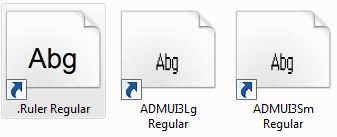

I am attempting to delete some non-system fonts that I installed.  Every time I try, no matter what the font, I am told that the font cannot be deleted because it is "in use".  It does not matter if I close every single program running and double-check that no word processors (I use Open Office) are running through Task Manager, the system will not allow me to delete any fonts.

The Windows Font folder itself is using the font, hence why you can't delete the font - i.e. the very tool you're using to delete the font is using said font and thus locking the file!
When in the Fonts folder click:
Organize > Layout > Untick 'Details pane' > Now try deleting the font.
Worked a treat for me.
