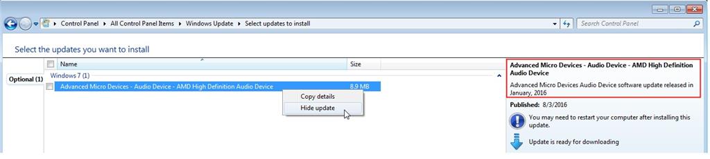

    Like others here, I have encountered the same message, although mine has to do with Intel HD Graphics 4600. I have verified that I have the latest version of 4600, which is probably why the "update" cannot complete.
    However, I usually put my computer in sleep mode when I'm not using it. I rely on the button that says "SHUT DOWN" to let me know when it's time to install Windows updates. How do I get it to stop reading "SHUT DOWN" and return to normal?
    In the bottom right hand corner, you should see two black arrows that point up. Click on that and you will see a blue paper looking symbol, it will have the windows icon on there. Click on that to open it up and show the updates that need to be done. When you see the choices, click on whatever update won't update properly. Right click on it, and click hide update. This will stop the "Shutdown" icon with the update symbol next to it in your start menu. This will also stop the update from trying over and over, even though you are up to date with everything.

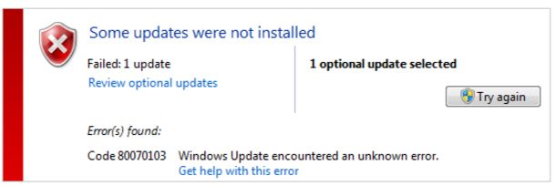

    If your system is working and you want it to keep working never accept hardware driver (chipset, video, audio, network, printer) updates from Windows Update.
    Here's why:
    If you mean you are seeing something like this:
    That message is telling you that the driver update offered from Windows Update is an older or lesser version than the currently installed driver or has a lower compatibility rating than the installed driver.  That means you probably don't want that update and you should be glad the installation is failing.
    It is generally not a good idea to accept hardware driver updates (video, audio, network, printer) offered by Windows Update and if you ever see them it is best to hide them so you never see them again.  Only get hardware driver updates from your hardware manufacturers WWW site.

    If you see and can recognize those hardware driver updates offered you should right click and hide them:

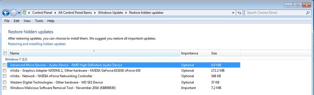

    Pretty soon you might have quite a few hidden hardware updates:
    Windows has a way built in to not allow these kinds of updates and I'm not 100% sure it works as advertised but this is a safe adjustment that may prevent a whoops event in the future and how you might undo them if they happen:
    Windows 7 has built in ways to disable driver updates from Windows Update that you can read about here:
    https://support.microsoft.com/en-us/kb/2500967

    If your system is working and you want it to keep working never accept hardware driver (video, audio, network, printer) updates from Windows Update.
    Here's why:
    If you are something like this:
