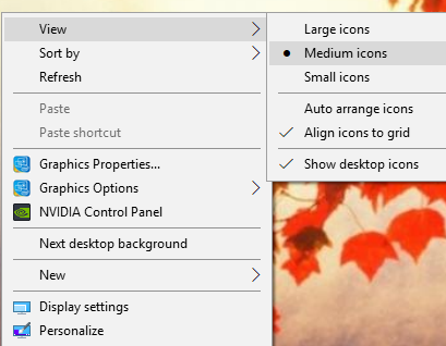

You can have the icon from the website, but it won't get larger: it's stuck at 16 by 16 pixels.  That's the way the icons on webpages are programmed.  It's not Microsoft's fault: it's just the way the world is.  If you forced MSN's website's icon to be large enough to match the size of the 'large' view desktop icons, this is what it'd look like:
Obviously they don't want people to complain about the ugly stretched-out icon, and since Microsoft can't replace the icon for every webpage in the world, they just leave it at the default size so it looks nice.
Since stretching them large would cause them to become extremely blurry, Windows leaves these low-res icons at their normal size, centered insize a box.
>> If you only want it to be as big as XP's was, you still can do that:  Just right-click the desktop, choose View, and then Classic Icons.... Classic is the size XP used.  The stretched example above is what it would be if you choose Medium or Large inside Windows Vista or 7, which is larger than anything XP could ever display.
