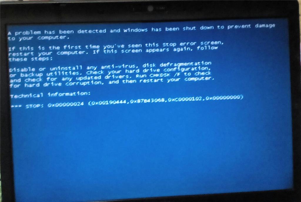

    I have the same issue all of a suddon my computer shut down now windows wont boot ,  wont restore , i cant go in safe mode, says there are no restore points,cant full restore cause it cant find back up files? im operating in a limited state and it just keeps wanting to run scan disk / repair but it stops and says vista cant fix  the problem?? My computer didnt come with a restore disk so now what?????????????
    2009-10-03T17:23:20+00:00
    I have a similar problem on my laptop.  And I believe the problem comes from a small icon on the start bar near the clock saying "New updates are available".  The icon looks like a light blue rectangle standing horazontally with the windows flag (4 small squares in red, blue, green and yellow, with a gold wing circling the blue shape.  It updates and installs, then when the cpu is shut down / restarted the normal windows update 0/3 comes up on the sigh in screen.  When the cpu is started again windows cannot start and the system repair cannot fix the problem.
    With my laptop I have 3 repair locations, of which one is an external backup of the C:
    I have tried manual repairing from both repair locations on the C: that come up with > Advanced Options > Sign in as Admin > System Restore.  Both of which say they have been restored but when the reboot comes round the same thing happpens, 2 options, cannot be fixed, windows never starts.
    F8 and safe mode does not work.
    Windows Complete PC Restore cannot find my back up even thogh its there and this pc can detect the external backup files.
    Windows Memory Diagnostic Tool reports RAM is is 100% fine.
    Command Propt "chkdsk" to reveal "Windows has checked the file and system and found no problems.  Followed further down by "Failed to transfer logged messages to the event log with status 50"
    "chkdsk /r" reports "Cannot be run because the wolume is in use by another process.  Would you like to schedule this volume to be checked when restarted"
    There is a blue screen which sometimes flashes up for less than 10ms.  I shall try to film it and get the error code if it comes up, if I do I shall report it here

    Hello again,
    I have found a route around the virus/bug.  The virus acts on the system restore and windows start up and not the F8 module.  Safe mode is not available but after several tries at manually restoring the systme I had to use F8 menu and select the "Restore from a previous working point"  (around the 6-8th menu down) , there is no loading, scanning or attempts at restoring for the virus to work so the system, HAPPILY, moves the user around the start up bug and you can sign in again.
