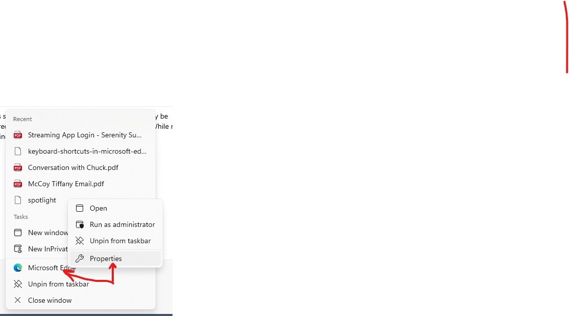

    Thanks for reporting your success. I wasn't sure exactly where to find this "shortcut" where I was supposed to edit the target so I gave up until I saw your post. Turns out there may be multiple shortcuts on the computer. One is on my desktop, but that is not how I launch Edge so changing it there had no effect unless I launched it using that shortcut. BUT, I start Edge from the taskbar. While not obvious, that icon on the taskbar is a shortcut too, but a different one. I made the change there and it indeed restored the colored folders. However it was not obvious how to access the shortcut properties.
    I finally discovered if you right-click the icon on the task bar, THEN right-click on "Microsoft Edge" in the popup menu (see attached image), it opens a second popup where the properties are accessible. Not at all obvious and I have an IT degree and spent 30 years in high tech. I don't know how non-technical folks cope. I guess they just accept what comes. Sorry, I don't live like that!
