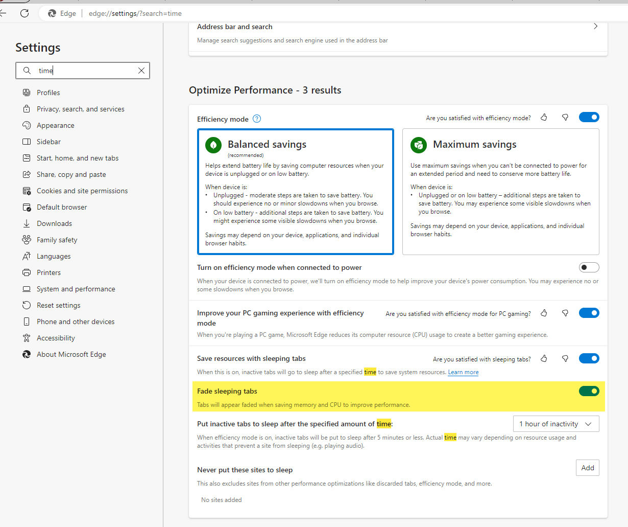

At first, I suspected this might have something to do with Sleeping Tabs since it sometimes occurs when I step away from my computer. When I return, if I click anywhere on the page display, it returns to normal. However, I tried disabling sleeping tabs when it occurred randomly (while I was using the page) and it still persisted.
Apart from when I have left the computer for a while and clicking, there is nothing that I have found that consistently restores the normal unblurred screen. I have had some level of success with opening new tabs (this sometimes fixes it), but this does not always work and is not predictable.

119.0.2151.42 (Beta) and 120.0.2186.0 (Dev/Canary) should have the fixes.
2023-10-24T21:59:22+00:00
I'll reply back with the Edge versions that have the change that allows "no policies" to imply "never blur for inactivity". The change that I previously mentioned that is in Edge Canary is going to require a second fix (due to technical reasons). Hopefully that will land in Canary within 1-2 days; and then both fixes will be taken together to Beta/Stable.

    @0x6f677548, in your reply to me (and to others), MAM occurs because of an automated process that rolls out policies to apps (in this case, Edge for Work - or maybe any device that signs in with a organisational account).
    Based on your reply to @SSatMS (in the same post), you said that you are experiencing the issue as well. You mentioned that you might deactivate the blur timeout as a test. Therefore, it sounds like it is a known issue without a solution - that is, the blur timeout shouldn't be happening when a tab is clearly in use? (While I was writing this, it happened again...)
    Please let us know if deactivating blur timeout prevents the issue. Also, to help those with administrative rights, please inform us how to deactivate blur timeout.
    2023-09-20T15:35:01+00:00
    By "Admin" I meant Intune Admin -- whoever is configuring Intune policies for your work account.
    A workaround that seems to work for me is to reactivate the window (so click on desktop, click on the blurred tab).
