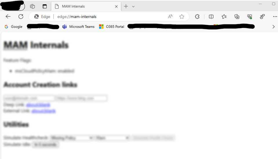

Sometimes when I am using MS Edge, the window display blurs seemingly without cause and stays there for a few minutes. When I say "window display" I mean it only applies to the Edge Work window I have open (I don't remember it occurring with other profile windows), and it isn't the whole window, but only the page display which is everything below the URL line.
At first, I suspected this might have something to do with Sleeping Tabs since it sometimes occurs when I step away from my computer. When I return, if I click anywhere on the page display, it returns to normal. However, I tried disabling sleeping tabs when it occurred randomly (while I was using the page) and it still persisted.
Apart from when I have left the computer for a while and clicking, there is nothing that I have found that consistently restores the normal unblurred screen. I have had some level of success with opening new tabs (this sometimes fixes it), but this does not always work and is not predictable.
Below are two screenshots - normal and blurred:

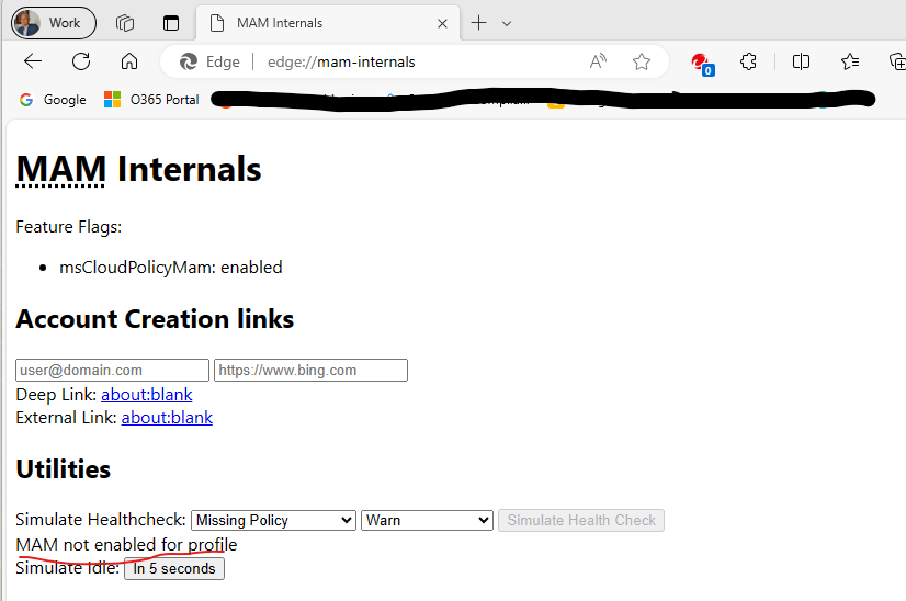

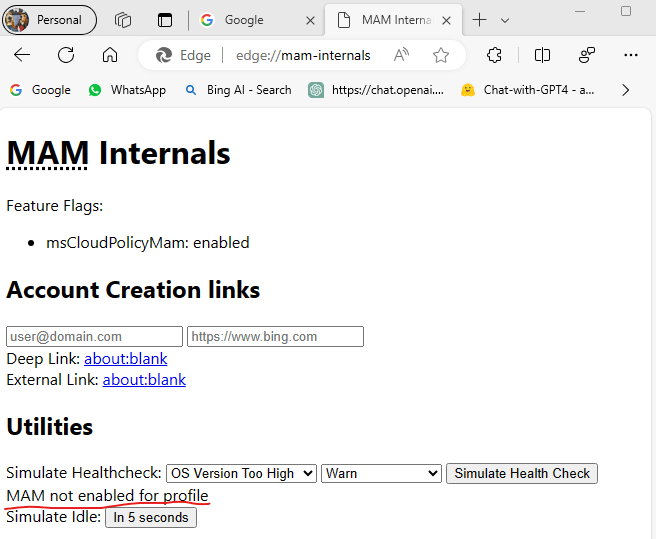

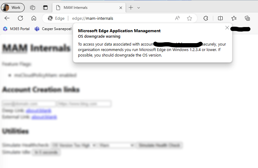

    OK. I think I figured out what is going on and the screenprints below will show what I mean. Will have to wait for the update to be released in Beta as per your comment.
    "Simulate Idle" button on edge://mam-internals is done on all profiles:
    Personal profile:
    No blur:
    1st Business profile with MAM and no policies configured:
    Blur:
    2nd Business profile with MAM not enabled:
    No blur:
    3rd Business profile with MAM and no policies configured:
    Blur:
    Note that on all profiles this is displayed:
