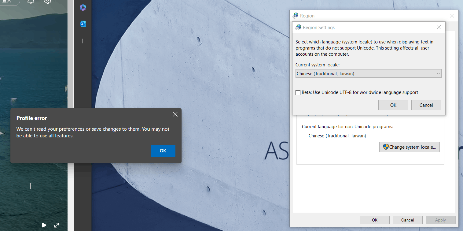

    Hello Mr.LesFerch,
    First of all, Thank you for your solution. I did make it work when my system locale is set to United states.Image
    However, it pops out this error message when the locale is set to my current location, Taiwan.
    Is there any fix for this? I'll just switch the locale to US if there isn't any anyway. Grateful for the script.

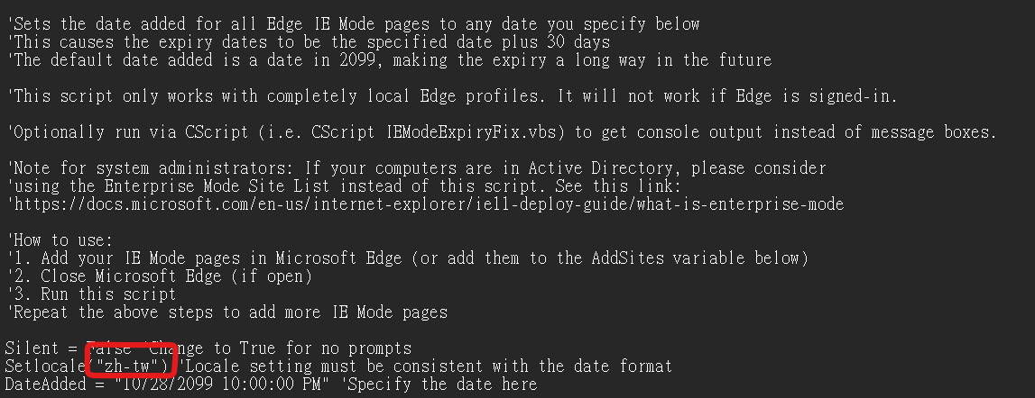

    I've poked around the script like changing the locale to zh-tw, no luck.Image
    Again, thank you very much for your solution. Have a great day master.
