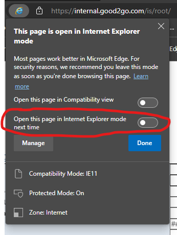

    With the latest version of the script (1.1.2) the pages should be adding successfully via the script. Please confirm.
    I added https://internal.good2go.com/is/root/ via the script and then started up Edge and tried that page. It opened up in IE Mode for me. However, that page redirected me to https://internal.good2go.com/is/root/logon/index.cfm. It's still stayed in IE Mode, but did not show that toggle switch on because that specific page is not in the IE Mode list. As long as you see the IE icon to the left of the URL, that switch can be ignored.
    If you like, you can add multiple pages from one site to the IE Mode list, although, usually you only have to add the parent URL. But, try adding all three of these pages:
    Edit: In my testing you only need to add "https://internal.good2go.com/" and all pages that open under that will be in IE Mode (IE icon will be shown to the left of the address bar). That IE Mode slider switch will be off for all child pages because that only indicates that the specific page is in the IE Mode list. It's admittedly a bit of a confusing interface.

    I experienced a situation where I had the sites in my IE Tab list, ran your script to extend the dates (successfully), removed them from the list, and then tried to add them via your script and they were not put in. That was earlier today. The version I used was downloaded at 11:00AM EST today.
    I just downloaded a new copy (2:00PM EST today) and it looks like the previous version I used. The tab can be reloaded in IE Mode, however, it is not starting out in IE Mode.
    I'm looking for this option to be set automatically so people don't have to worry about toggling that button.
