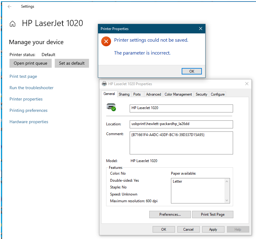

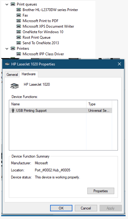

For information to everyone:
It’s disable to use printer HP LaserJet M1132 MFP after upgrading to build 21354.1: Printer is missing in the Device Manager, Settings/Printers & Scanners shows “HP LaserJet M1132 MFP  Offline”,   Print Queues shows the documents sent for printing, but printing doesn’t run. Troubleshooter Windows does not detect any problem. Returning to the build 21343.1000 resolves the trouble.
Feedback https://aka.ms/AAbw91b

    To add a printer it needs to find one, but it does not find the USB printer :-(

    Yes, I can confirm that both the desktop and the notebook with versions prior to 21354 were all fine without problem, since they were updated to the latest release, if the printers are no longer working in print, the error that comes out is the one you described in the comments previous, the printers I have are these:
    Samsung ML 2010R
    HP Photosmart B109a-m
    On both when printing the same error occurs only that in the HP the icon appears as if it worked fine while the Samsung detects it as an unknown object despite the name being correct
    This is the report that comes out in Problem Details, it seems that during printing spoolsv.exe crashes
    Description
    Path of the application that generated the error: C: \ Windows \ System32 \ spoolsv.exe
    Issue signature
    Problem Event Name: BEX64
    Application Name: spoolsv.exe
    Application Version: 10.0.21354.1
    Application timestamp: 3a0cc8c9
    Failed module name: ntdll.dll
    Module version with errors: 10.0.21354.1
    Module timestamp with errors: b77de05a
    Exception offset: 0000000000092aff
    Exception code: c0000409
    Exception data: 000000000000000a
    OS version: 10.0.21354.2.0.0.256.48
    Locale ID: 1040
    Additional information 1: 01fb
    Additional Information 2: 01fb88d76210914605406d4b529fb3af
    Further information 3: 8aea
    Additional Information 4: 8aea82dfbca0538ee1e54773ab2f1029
    Learn more about the problem
    Bucket ID: 98ae14e90cb92ae09436494e92970408 (1456432131316581384)

    Same issue with a Brother HL-5240 USB printer.  Luckily, my HP WiFi printer is working OK.
