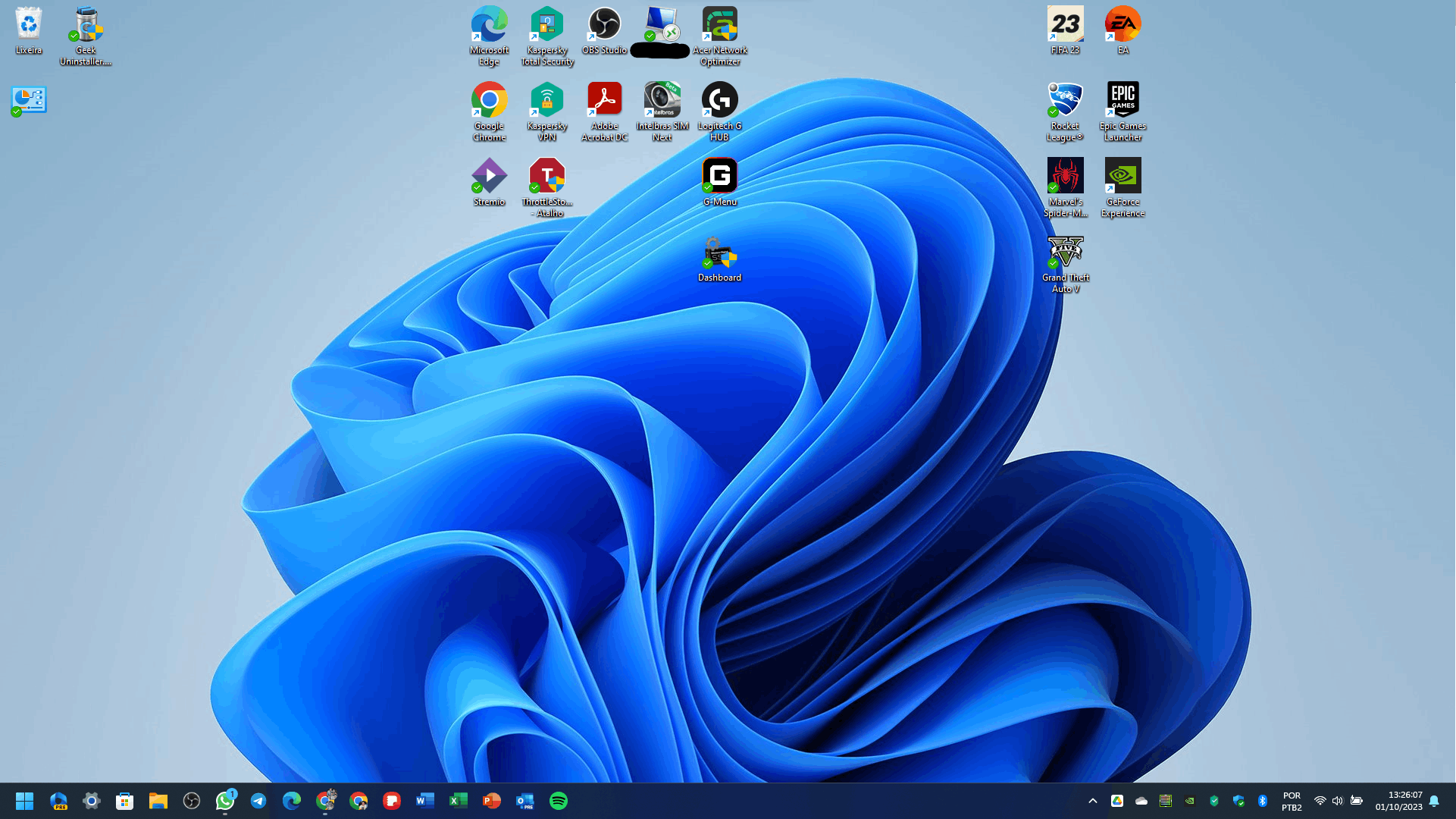

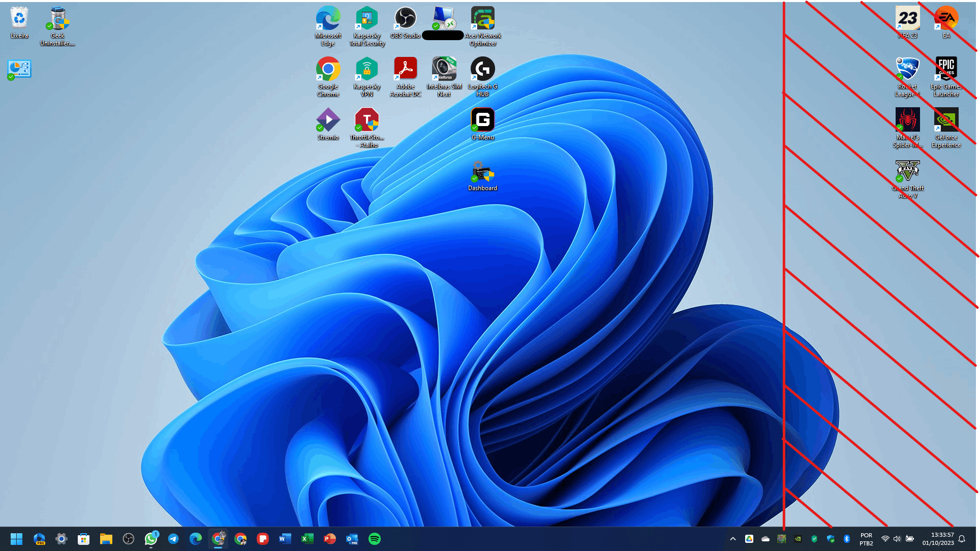

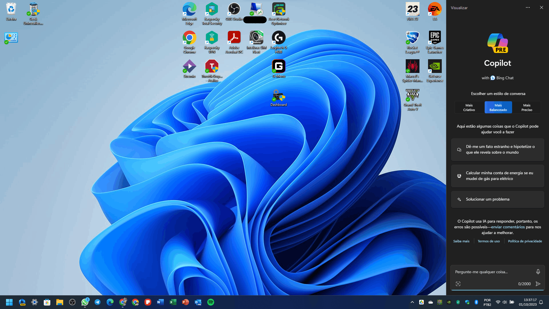

    The problem isn't the resolution. I was facing the same issue and all I had to do was remove shortcuts from the far right corner where copilot appears... I was both shocked and relieved to see that it wasn't showing for such an absurd thing...
    I have just moved my games like shown, rebooted my PC and Copilot magically appeared...

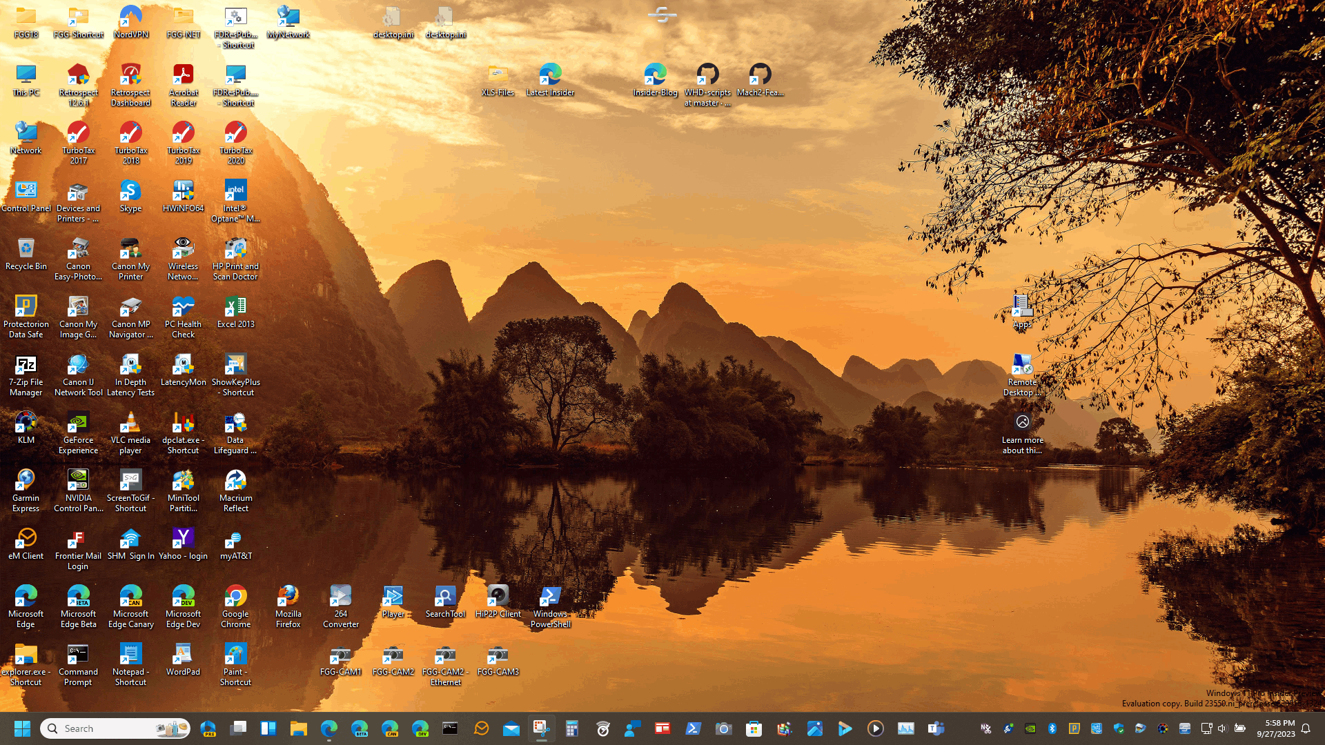

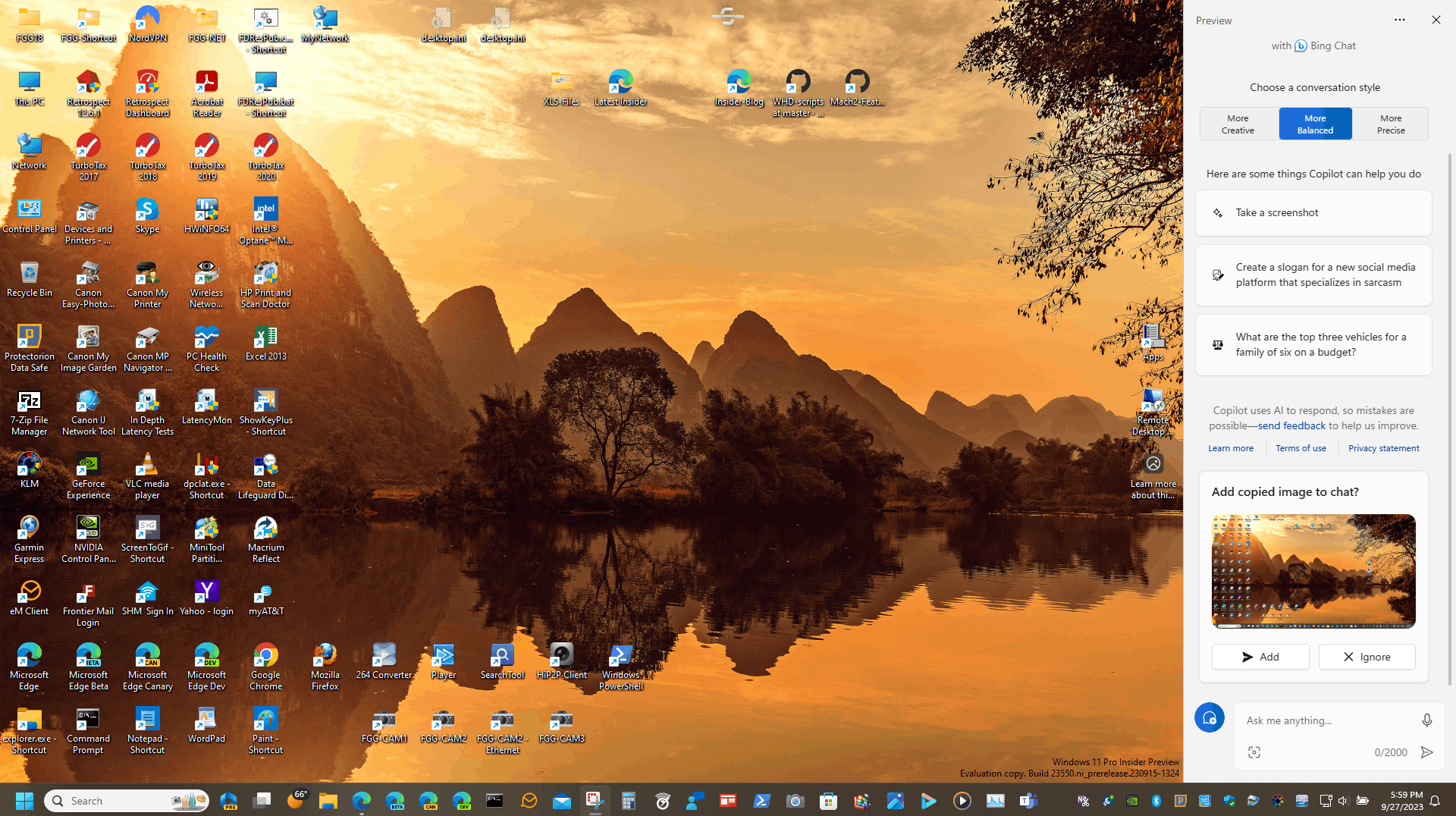

    This is my Display settings because this is
    what I prefer. I do not have a large monitor or use UHD.
    Thanks.
    Is the Scale set to recommended or some other value?
    I don't think MS is doing enough testing with different Resolution and Scaling.
    Scale is set to Recommended.
    I have the problem also in this laptop with these settings, both recommended and not UHD. 😜🤷‍♂️
    Had to rearrange them all by leaving space on the right of the screen for the Copilot side bar.
    Then it finally worked, but only with the above recommended settings for the display. Scale and Resolution.
