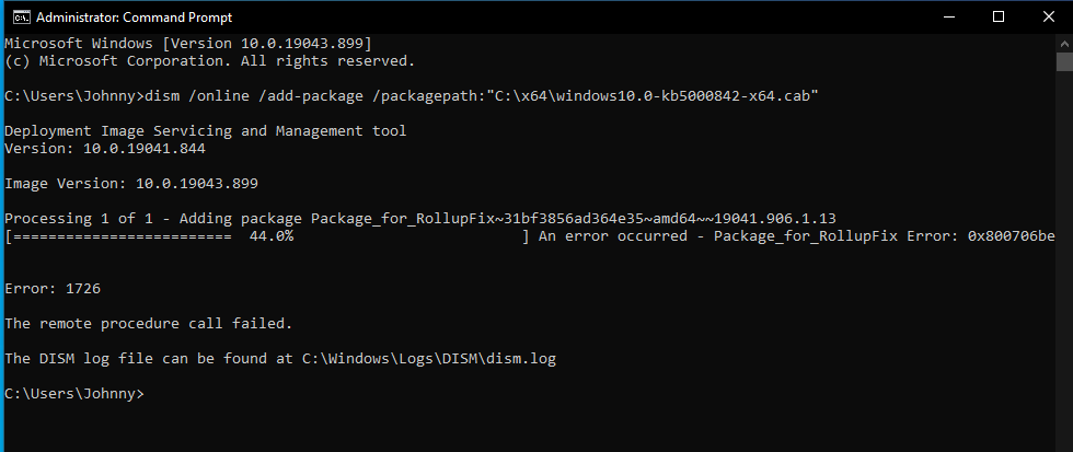

Johnny,
Here is the update from 19042.870 to 19043.906
This was all done with W.U.
No more error 0x80073701 like I had with 19043.899 on machines that went through 19042.868.
Looks like they solved that issue, W.U. to 19043.906 now worked fine also on machines that went through both 19042.868 and 19042.870 and were failing solid with W.U to 19043.899. 😊
But 19043.899 created this new mess with error 0x800f081f.
As you pointed out the 2 kb5000842 are different and the one in 19043.899 is the one causing the problem.
If they change an update file shouldn't they change the KB number ? Something is definitely wrong.
I think they did the same type of mistake when they went from 19042.868 to 19042.870 then they pulled the update and released it again 1 or 2 days later.
03/26/2021 12:04 AM 559,903,750 kb5000842.899.fc78dc78-9f5f-47f6-8754-6c9555f795ca
03/25/2021 11:57 PM 561,385,402 kb5000842.906.2f8a5873-fa6f-4d03-833d-b6fff95b712b
