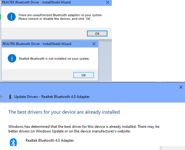

Please don't send me to the Community page. After uninstalling and reinstalling the radio, the computer now shows I have no Bluetooth at all. I already tried everything (Device Manager, etc.) I have Sony WF-1000XM3 earbuds. I'm running a 64-bit O/S. I'm running W10 version 21H1 (OS Build 19043.928)
I bought a dongle (USB 4.0). The file manager doesn't recognize the drive. It looks like my computer isn't granting permission to the flash drive, although the port works fine with everything else. When I view the properties on the Realtek Bluetooth 4.0 Adapter, the device status indicates it's working properly.
Should I start all the Bluetooth functions that are currently on manual and put them on automatic? I uploaded the Bluetooth Audio Receiver and cannot open a connection: those options are grayed out and it's on idle.  Are there other troubleshooting options I can do to fix the problem in case this doesn't work?

Can you remove the Broadcom device and make sure Bluetooth device that came with the motherboard is enabled in the bios, then make sure the drivers are installed ( get the drivers from the Asus's site), then check the device manager to see if it is working, if it is then try and connect your earplugs to it.
It hard to figure out if its a problem between the Bluetooth hardware and the operating system or is it a problem between the Bluetooth device and the device you are trying to connect which is the ear plugs
2021-04-26T17:00:01+00:00
You appear to need some chipset drivers.  The ASUS download site is bad about hiding different drivers in the same grouping.. make sure and show all to find additional drivers.
Have you disabled the Realtek Bluetooth device?  If this is an ASUS motherboard or system, can you give us the model number?
You ear buds are Bluetooth 5.0.  Maybe the new build version does not like 4.0..  Bluetooth dongles are not very expensive, you could probably get a 5.0 or 5.1 one fairly cheap

    I disabled the Bluetooth device then restarted it. I tried removing the device and BCM 20702A0 disappeared. In the Device Manager, the Realtek device shows a caution icon.
    Bluetooth doesn't work without the dongle. DDR5 devices are backwards compatible.
    The device is an Insignia. It's 4.0 but compatible with Windows 10 (but not my earbuds?) I reset the earbuds and disconnected them from my DDR5 Android.
    The motherboard has a H110i chipset. Full specs [https://origin-www.asus.com/Tower-PCs/G11CD/specifications/]
    You're right about ASUS. I can't find a driver released later than 2018 [https://us.driverscollection.com/?H=G11CD&By=ASUS&SS=Windows%2010%2064-bit]
