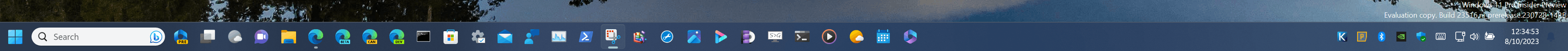

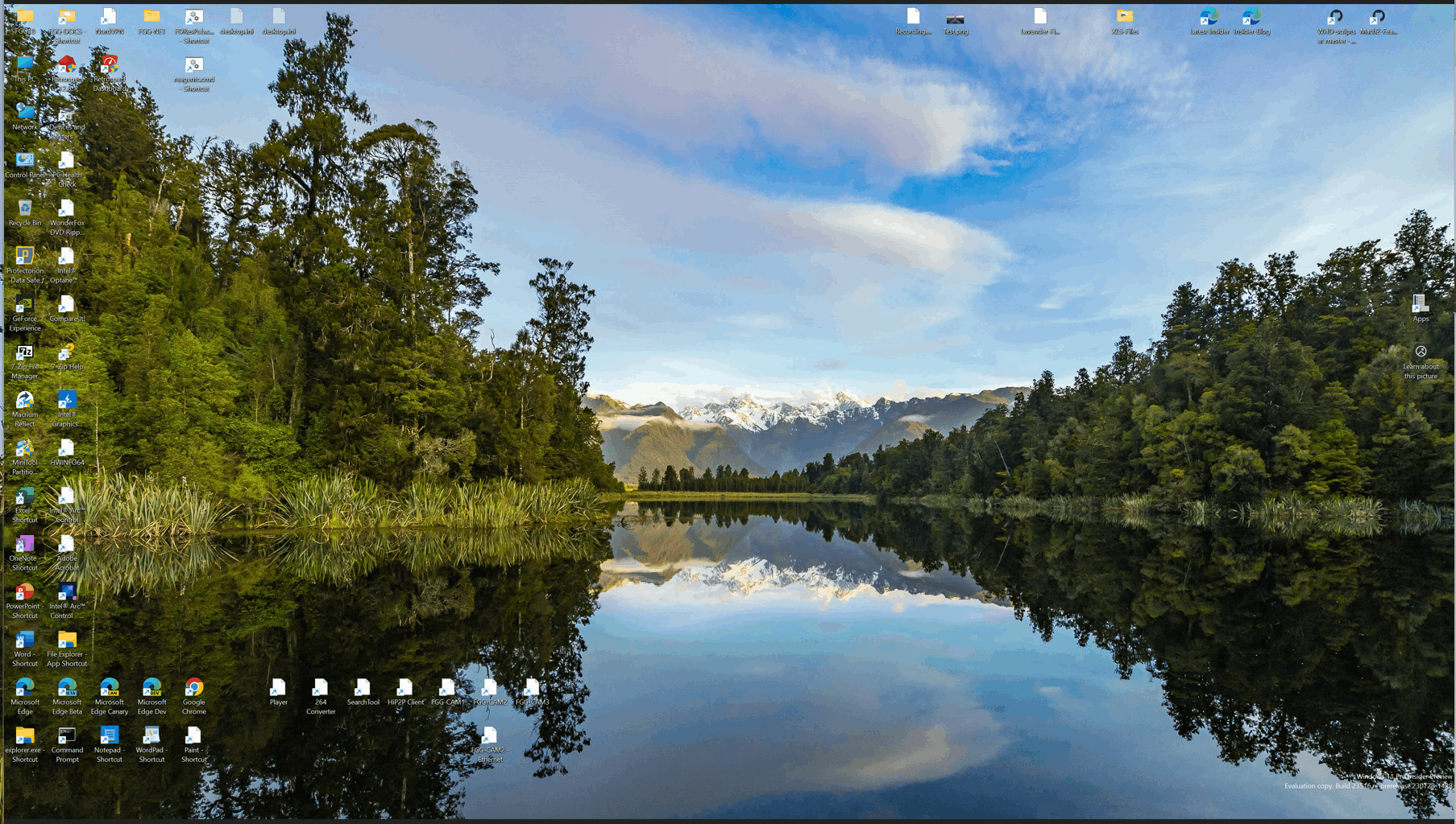

    I finally got the problem with 23516 after restoring an Image backup. Same behavior that I saw already with previous Dev Builds.
    Taskbar missing. 🤐
    To get it back I just did what ChrisLeipold suggested in the post above, Ctrl + Alt + Del and sighed out, when I signed back in the taskbar was there again. 😉
    After signing back in the taskbar was there again.
    On following reboot, it was back to normal. 👍
