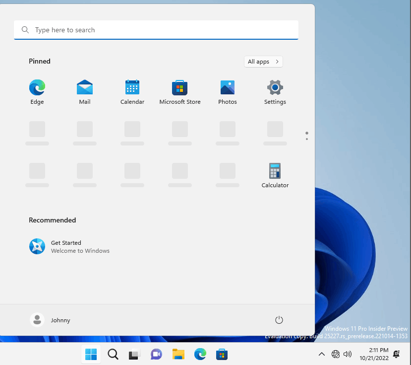

    Hi Johnny,
    Here is my workaround for the BSOD bug on the clean install.
    It worked fine with both fully compliant and non-compliant boxes.
    I just took the 25217 ISO and replaced the install.wim in the Sources folder with the one from 25227 ISO.
    I could install 25227 system without any crash for BSOD or any other errors. πŸ‘
    This below was a clean install of 25227 on a legacy BIOS laptop, and everything came up fine. 🀣
    Now we'll see how long we have to wait for MS to fix the BSOD bug.
    Maybe on next build, who knows? 😎😎
    Have a nice weekend.
    I can also now see Smart App Control set to valuation, which requires a clean install. πŸ‘Œ
    Edition Windows 11 Pro Insider Preview
    Version 22H2
    Installed on β€Ž10/β€Ž21/β€Ž2022
    OS build 25227.1010
    Experience Windows Feature Experience Pack 1000.25227.1010.0
