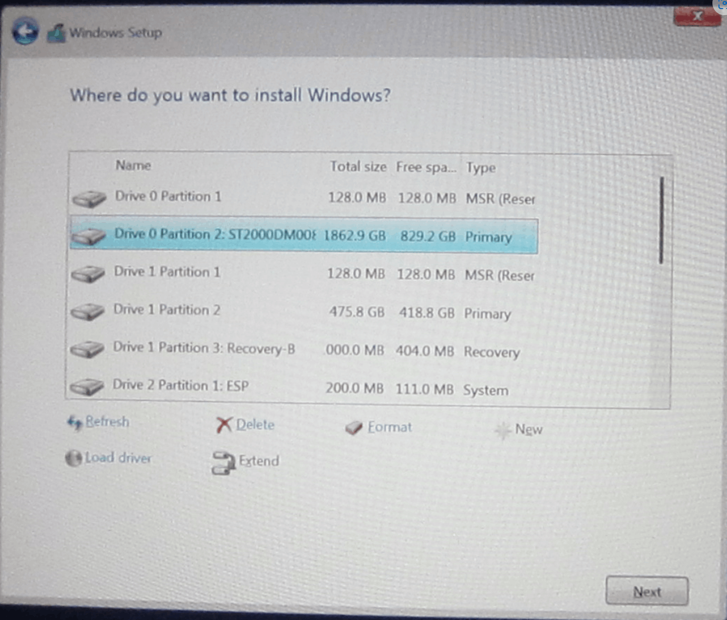

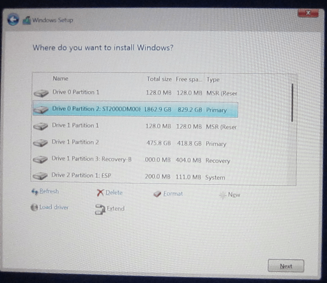

    Here is the other case, I mentioned above, I get the BSOD reproduced consistently just trying to scroll to select the drive partition where to install.
    Note that if I select the drive partition directly without scrolling, the bug does not happen, and I can go on formatting and installing. 🀣
    You may not even have the scroll bar in your system if you don't have many disks with multiple partitions. πŸ€·β€β™‚οΈ

    I'm now using the original MS official ISO and get the exact same failure with either Home or Pro editions.
    Also, I found an easier way to get the error by simply trying to scroll on this screen as I mentioned on previous post.
    Pretty consistent with either Home or Pro. πŸ€·β€β™‚οΈ
    Clearly if you don't have the scroll bar on the right for this screen that does not apply. 🀣🀣🀣
