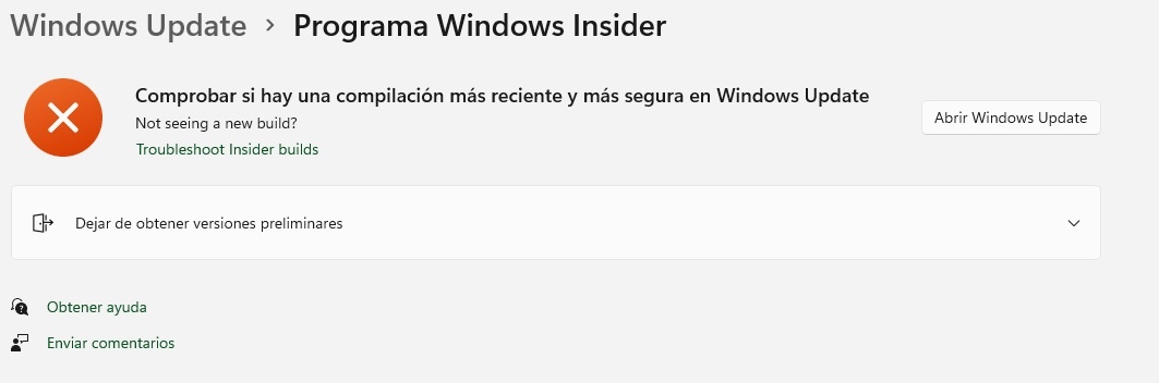

    ‎When I run the first command I get this error:‎
    C:\WINDOWS\system32> bcdedit /set flightsigning en
    ‎Boolean data is not valid as specified. ‎
    ‎Run "bcdedit /?" for command-line help. ‎
    ‎The parameter is not correct.‎
    Hi JoséMiguel6,
    The fix is only for the original picture and I think it only happened with build 22000.100.
    Can you post a screen shot of your insider page and also type winver in search and hit enter and post back your build.
    bcdedit /set flightsigning on (on your post you wrote en instead of on

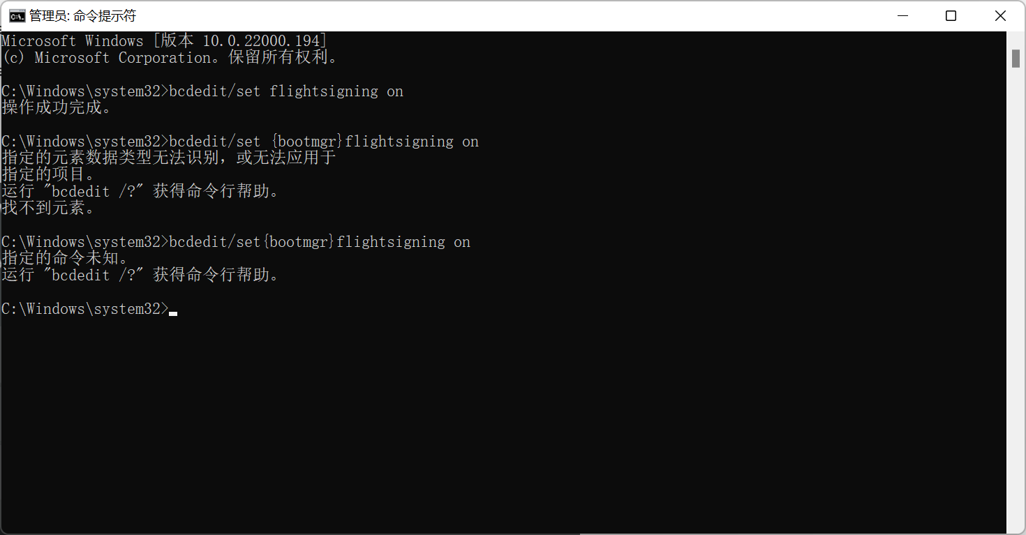

    I get the following message:
    The boot configuration data store could not be opened.
    The volume for a file has been externally altered so that the opened file is no longer valid.
    This is probably the result of moving my install from a spinny disk to NVME memory.
    How must I edit the BCD to fix this?
    2021-10-01T09:31:30+00:00
    并不像解决方法里说的那么顺利,显示命令未知,怎么办
