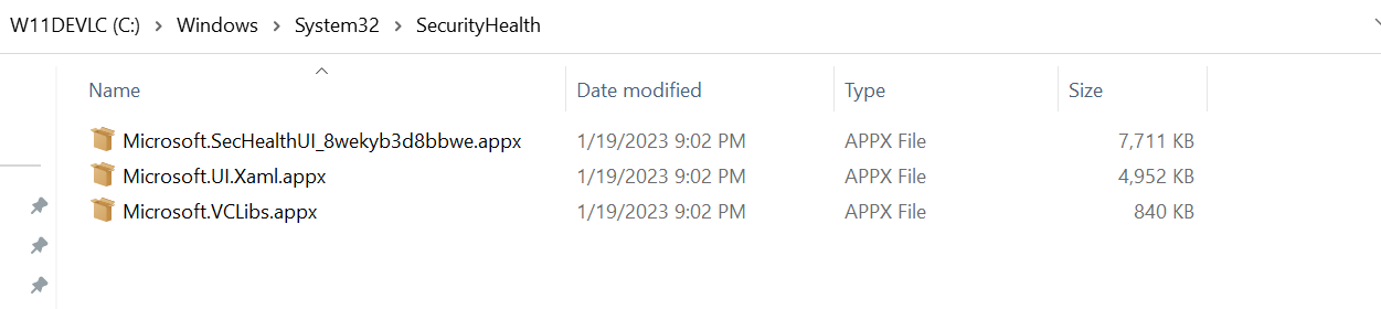

    This is the same mistake that MS made last year with 21H2 and 22H2, they were downloading security updates incompatible with the Windows Build currently on the machine. Pauli O has a machine that shows KB5007651 updates from 2109 all the way up to 2301.24001.
    The old ones are not in the History also because they go together with all the defender updates, and they only keep the history for the last 50. But I got also a case last week with 2301 that did not show in the history, yet it was installed.
    If I remove them, the latest one gets reinstalled as soon as I check for updates.
    Yet I have a third 25284 machine that never got any KB5007651 and that folder has only the ones installed by the 25248 upgrades.
    I checked for updates several times and never got any of those KB5007651 at all.
    Could not figure out why the different behavior. May be another A/B testing B.S. who knows?

    With Build 25284 there is no need to fix it, because 1.0.2301.24001 installs version 1000.25285.0.1000 which is compatible with 25284 Build.
    It was creating problems when it got installed in Build 25281, but after updating to 25284 it works fine.
    The problem Pauli shows is that it got installed on Build 22621.1105 and it creates the same issue we saw with 25281.
    When I fixed it in 25281, W.U. reinstalled the damn faulty update and the problem came back.
