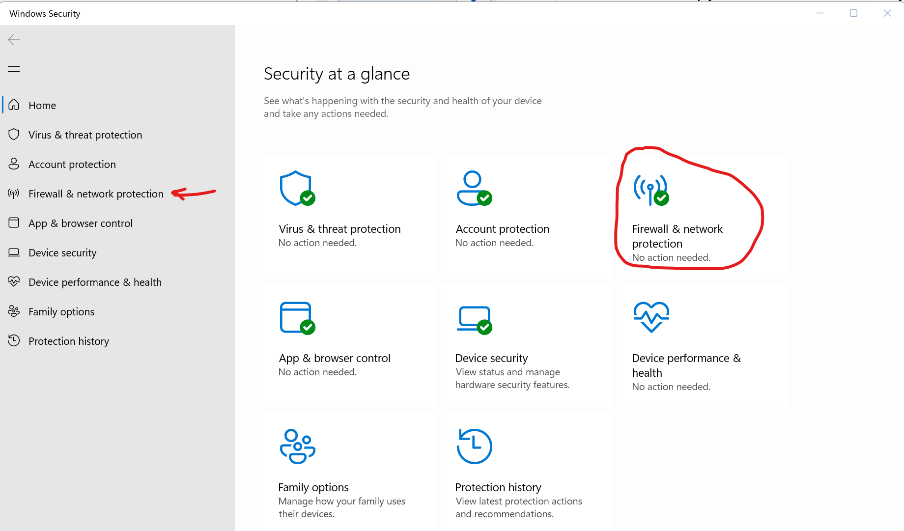

Right after the update shows yellow warning on security icon:
Everything green here, but Firewall & network protection is missing, that may be the reason for the yellow warning.

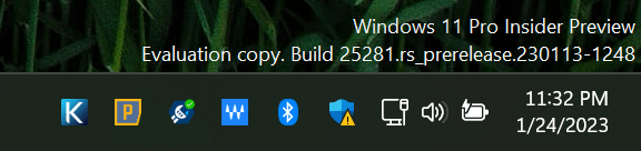

Missing Security icon from System Tray after a reboot:

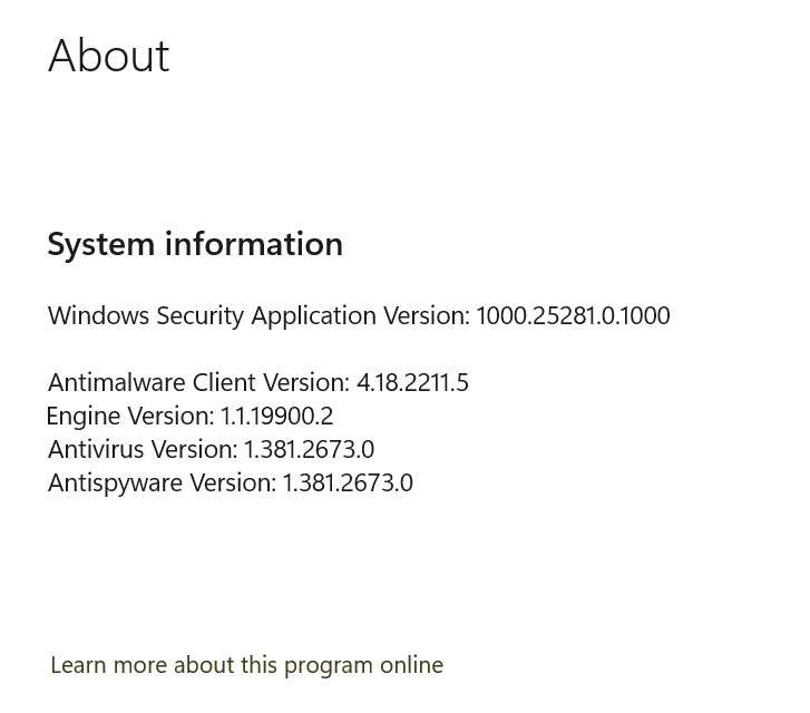

    Hi fg,
    This is what I've got just a few minutes ago after booting a VM
    2023-01-25T06:02:07+00:00
    Hi Sibro,
    That 25281 is also what I get on one of my machines and that is fine.

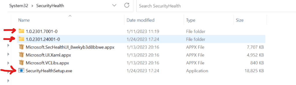

    The problems started on the ones that had kb5007651 installed previously starting with Build 25272. CK had the same issues.

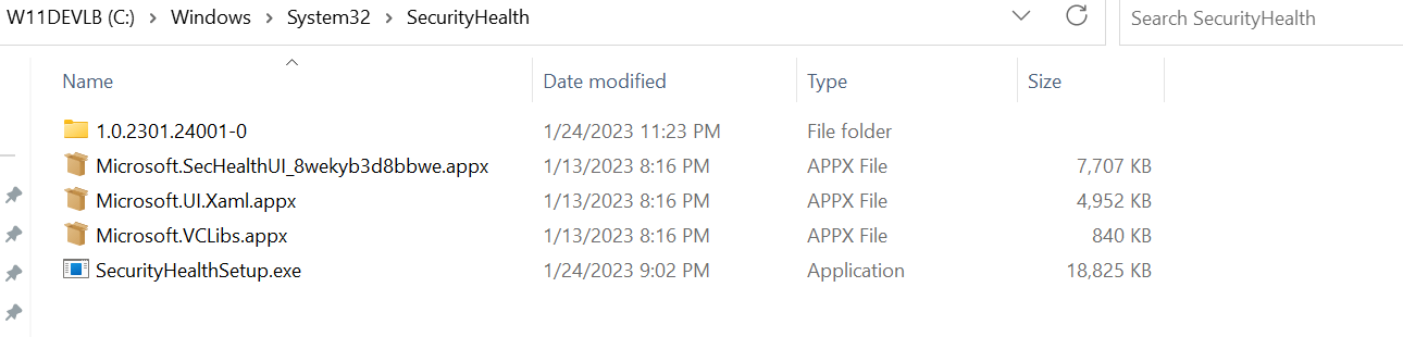

    See the dates of the update 1.0.2301.7001-0 and the second today, version 1.0.2301.24001-0.
    Those are the ones that mess everything up. They are not just antimalware platforms they also update the Microsoft.SecHelthUI.
    The 1st one was for version 25276, the second one id for 25285.
    They should not be downloaded on 25281.
    They made the same mess before, months ago, with 22621 Builds. 🤣😜🤷‍♂️

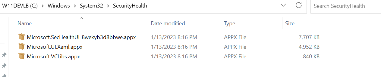

    If I delete the extra stuff in SecurityHealth folder and reinstall the version 25281 the problems go away.
    See here what that update installs, 1000.25285.1000.0. 🤣🤣🤷‍♂️
    One machine without those kb5007651 updates gets 1000.25281.1000.0 and no issues.

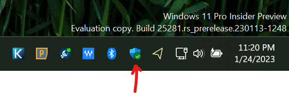

    This VM is a clean install of 25281
    So bottom line is only builds that have been updated are affected correct?
    2023-01-25T06:23:23+00:00
    Not necessarily, I have one without the problem and it was updated to 25281 from previous builds, but never got any of these kb5007651 (1.0.2301.xxxxx) security updates.
    I have no idea why I got the updates on 2 machines, but not the third one. It does not make any sense. 🤷‍♂️
