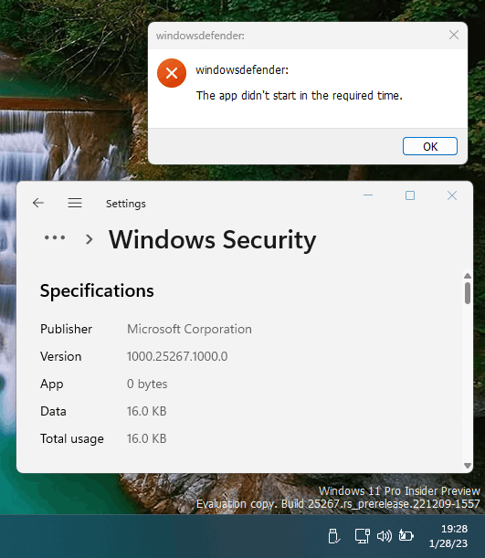

Right after the update shows yellow warning on security icon:
Everything green here, but Firewall & network protection is missing, that may be the reason for the yellow warning.
Missing Security icon from System Tray after a reboot:

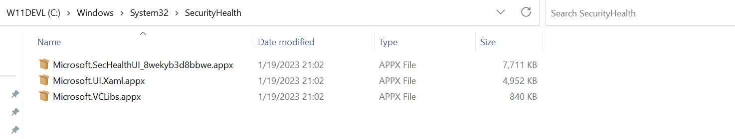

    Before the upgrade I verified that SecurityHealth folder was empty.
    None of those KB5007651 were downloaded or installed after the upgrade.

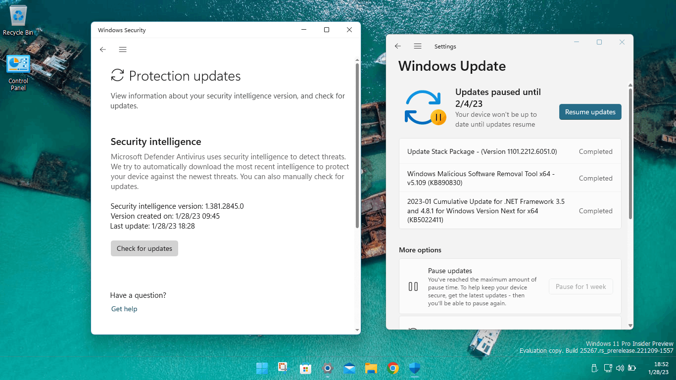

    I checked for updates several times and it is not getting any of those Security App updates.

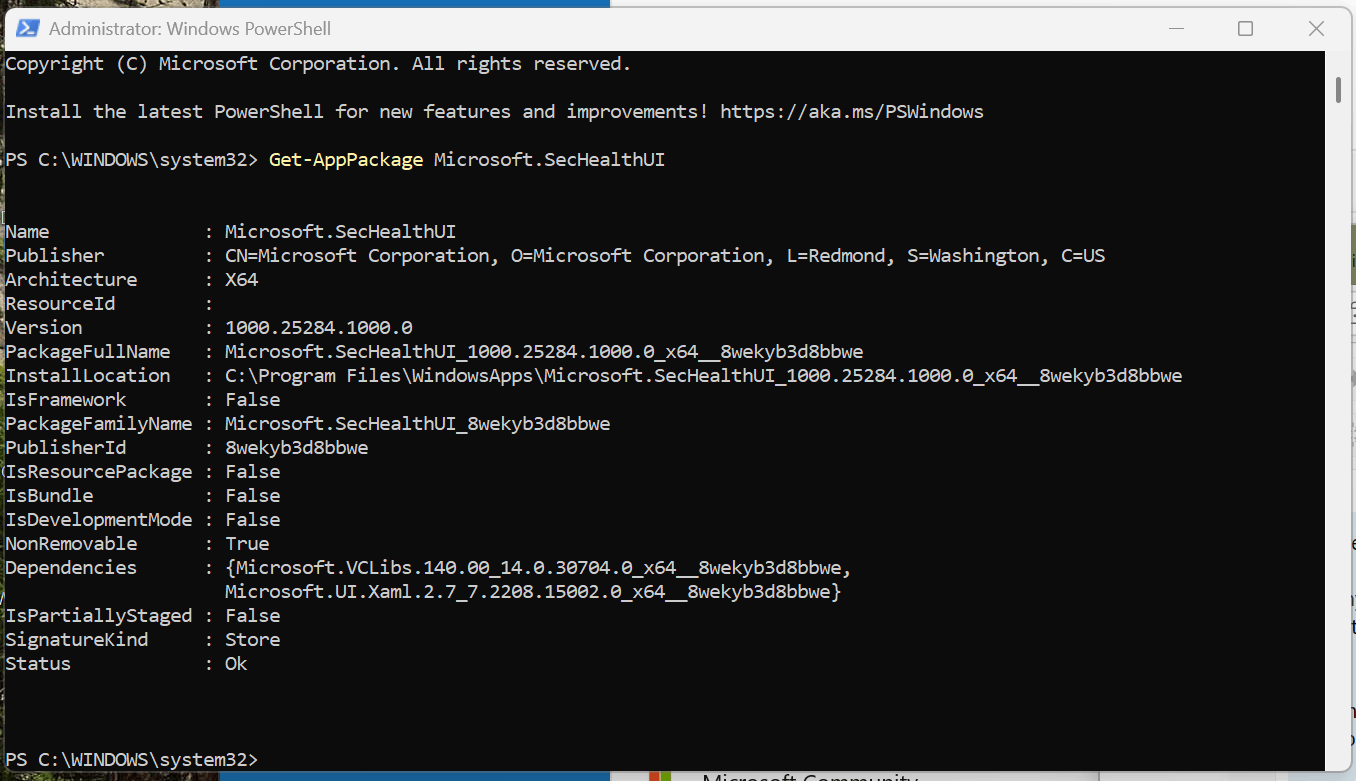

    Currently it just shows the Security App Version installed by the 25284 upgrades, none of those 2301 folders in SecurityHealth folder, nor the SecurityHealthSetup.exe. 😉

    I managed to stopped KB5007651 while online with and without updates paused but there are consequences, the icon is still missing and Security doesn't open anymore. 🤷‍♂️
    Paused updates after those 3 to avoid 25284
    May not be worth it to you but if you're interested, I will try to retrace the steps if I can. 🤣
