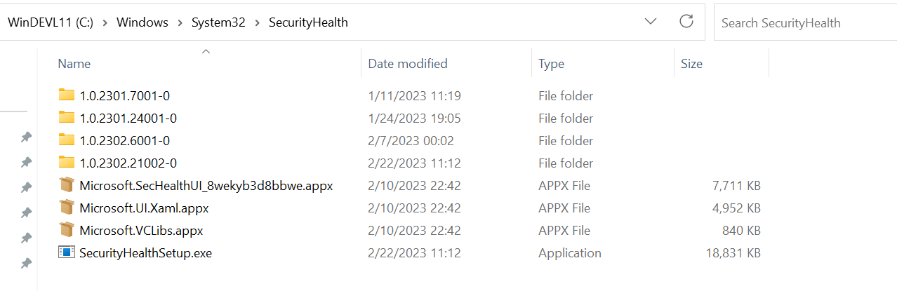

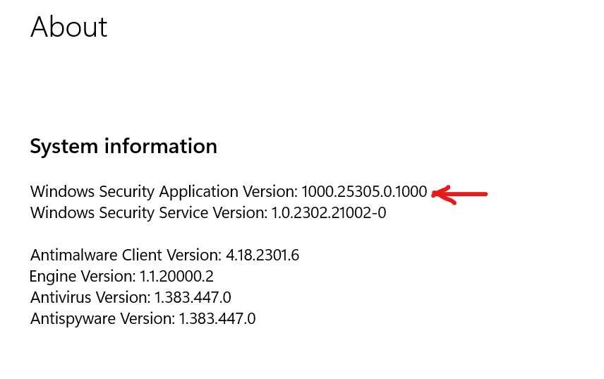

    The problem started back with Build 25272 when it updated security with KB5007651 (Version 1.0.2301.7001) which changed the security version to 25276.
    Now KB5007651 (Version 1.0.2301.24001) is bringing the security version to 25285 and clearly it is no longer compatible with Windows Build 25281.
    It is the same mess that they created months ago with Build 22621.
    https://aka.ms/AAjcnfy
