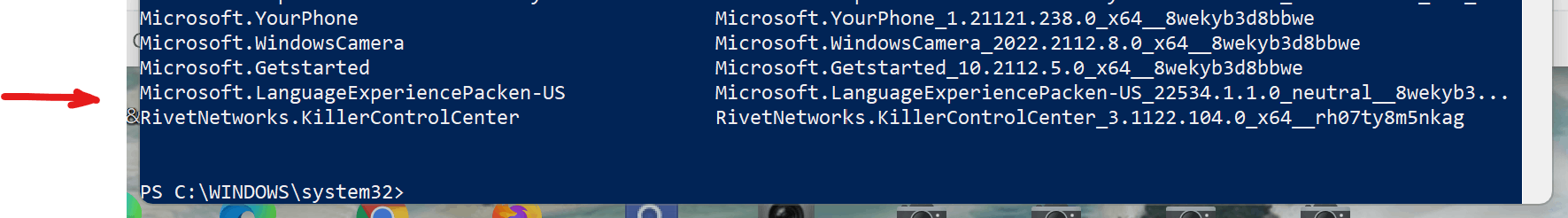

    To find Apps full names use
    Get-AppxPackage -AllUsers | Select Name, PackageFullName
    Using asterisks makes it easier.
    Get-AppxPackage *LanguageExperiencePack* | Remove-AppxPackage
    Then, you can install the correct package but as already explained by fg, to avoid the bug you have to install the previous version.

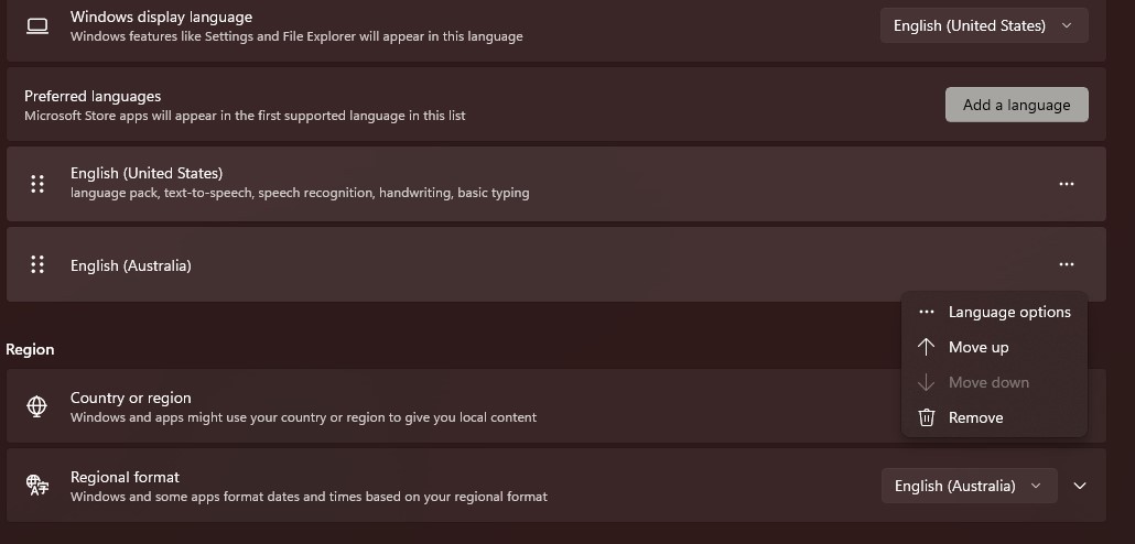

    Perhaps I got this wrong, but I could delete my added language pack

    The one causing the problem is not the basic language package, it is the English (xxxx yyyy) Local Experience Pack that is added through the MS Store.
    With the command below on P.S. you can find out if there is one installed, the one showing here is before the update that screwed up, Version 22534.1.1.0 was fine, the bugs started with Version 22535.1.1.0 for the US pack.
    Different versions for other languages.
    Get-AppxPackage -allusers | Select Name, PackageFullName
    https://aka.ms/AAfh4l3https://aka.ms/AAfgzml
    2022-01-15T18:15:53+00:00
    Sorry to butt in, but I believe you can change, or delete it via Control Panel. Same with the keyboard

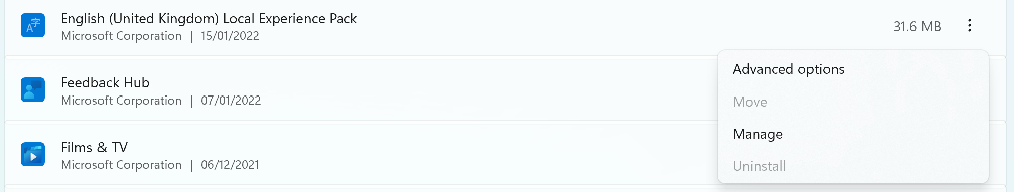

    Hi vienna10,
    The option to uninstall is not available.

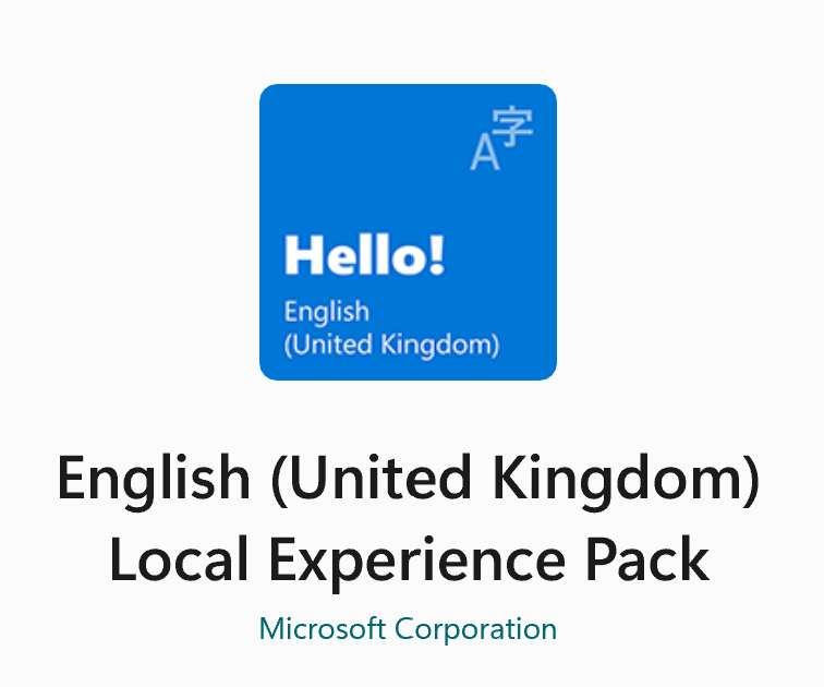

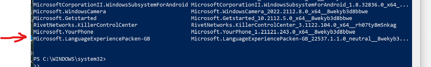

    Here is the full name for the English (United Kingdom) Local Experience Pack:
    Microsoft.LanguageExperiencePacken-GB Microsoft.LanguageExperiencePacken-GB_22537.1.1.0_neutral__8wekyb3...
    Here is the P.S. cmd to remove the en-GB pack:
    Get-AppxPackage Microsoft.LanguageExperiencePacken-GB -AllUsers | Remove-AppxPackage
