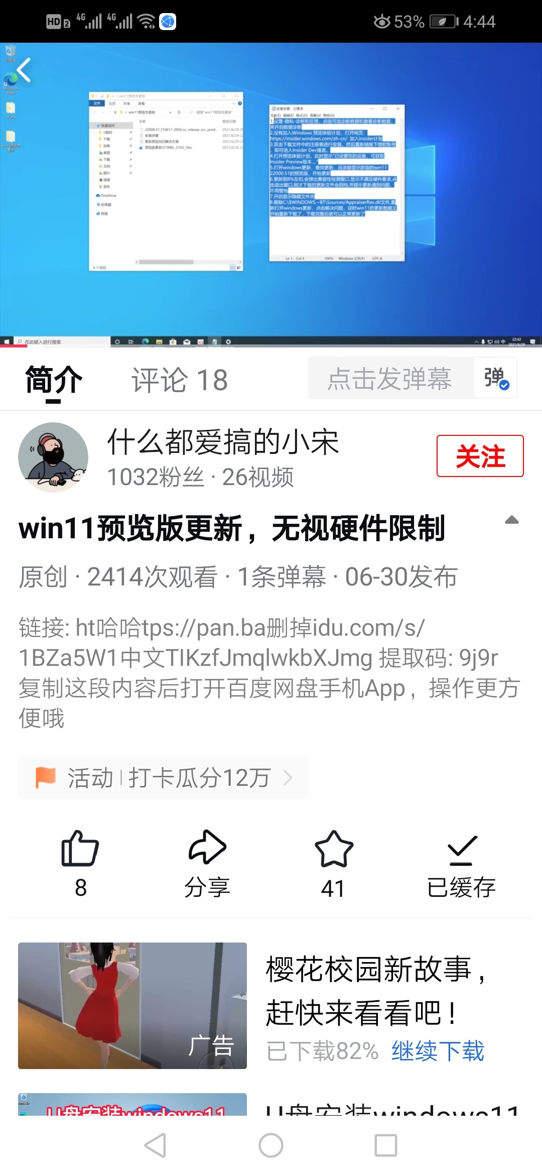

    你觉得这个可信吗?工程师,我在西瓜视频看的

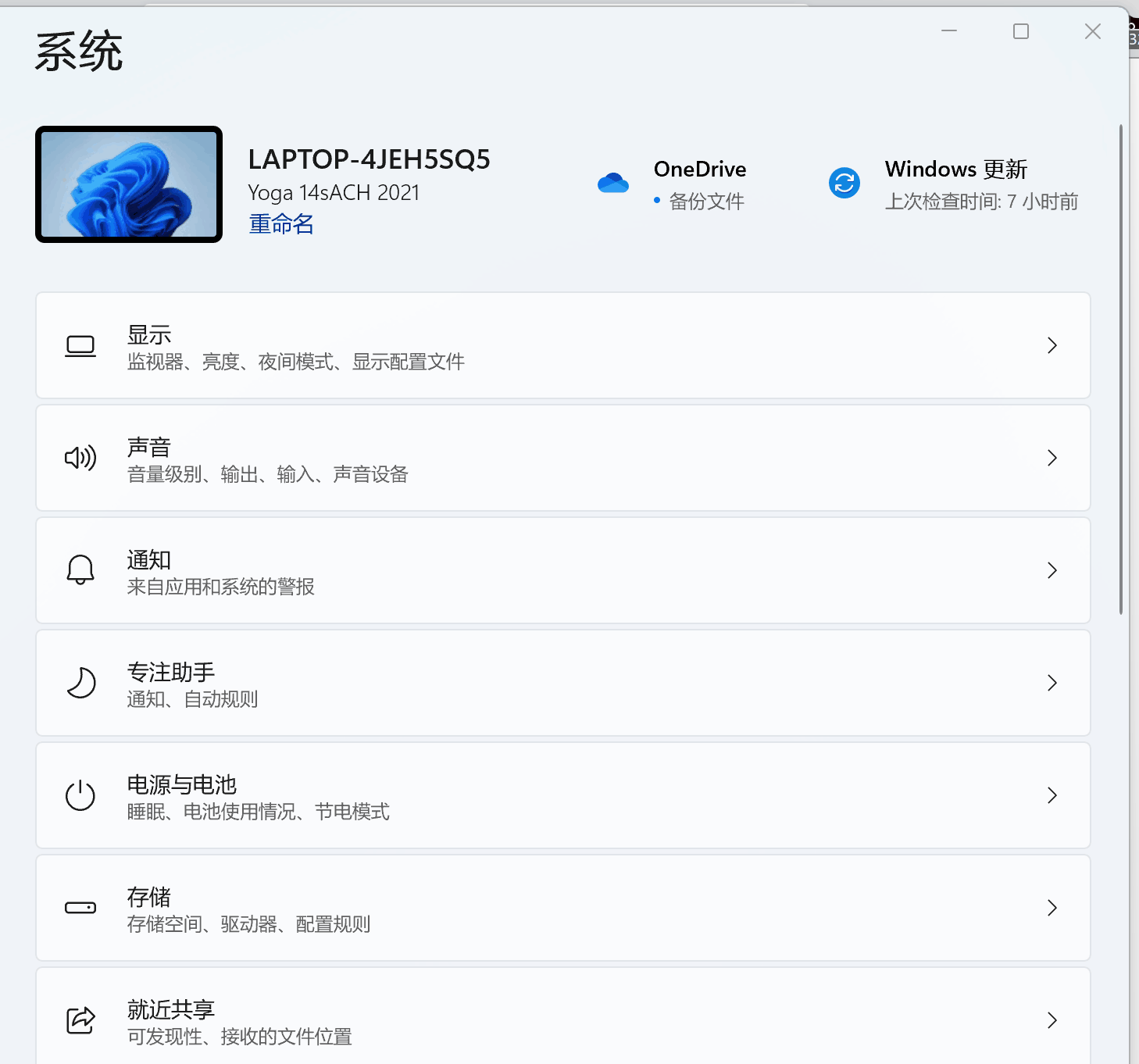

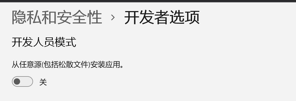

    There are some bugs in the Settings app. (22000.71)
    1. Can not enable Developer Mode:
    1. Unable to open "Power and Battery" .
