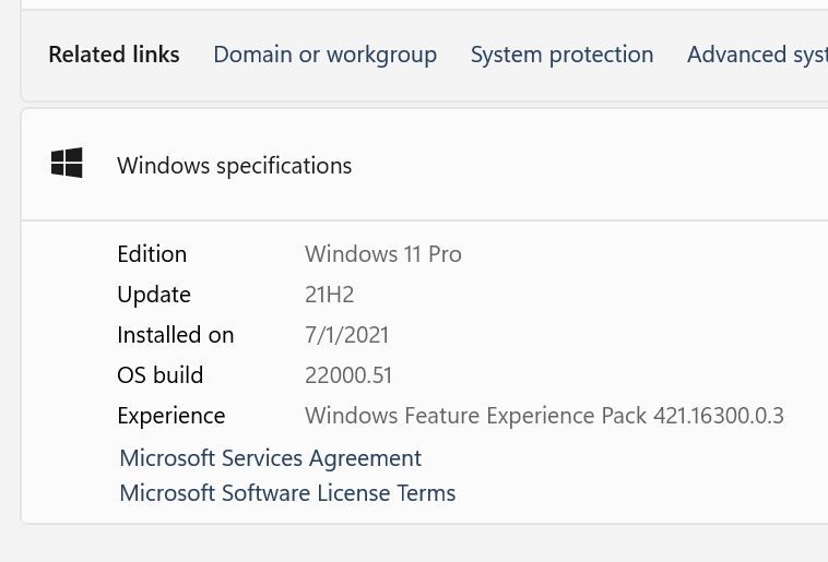

    15th attempt reinstall, enabled Ftpm-everything, cleared it cleaner than a windexed window.
    Installed ".net" 3.5 and 4.8 (because some guy said to)
    Did I mention it installs 100%, but then UNinstalls??
    Yeah.

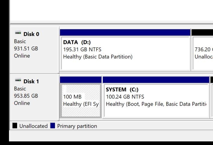

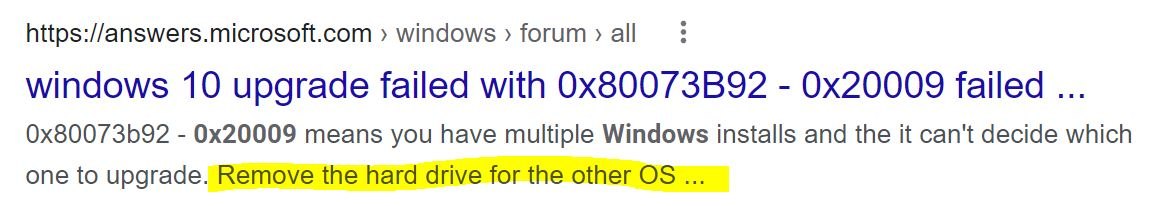

    MARK all other drives OFFLINE for immediate success.
    35 years of windows installation-programs and NO one else thought to program the installation file for multiple drives???
    O ... My ... Gosh.
    Can I wildly speculate?? Because I'm mostly talking to myself anyway...
    My data-drive (an nvme) is technically drive 0 and the System drive is technically drive 1.
    When Preboot reaches out to "drive 0" it melts, has a brain-infarction, whatever.
    If I tore my pc apart and removed one of the drives (the data-nvme) it might not faint.
    But tearing apart a pc is already risky, and with no confirmation, I question whether it's worth the trouble.
    Success!! Offlining The second Drive helped!
    But did I need to do that? (yes)
    Couldn't windows *know* where the C drive was? (no, apparently)
    Did any one else have this solution?? (It should be a sticky)
