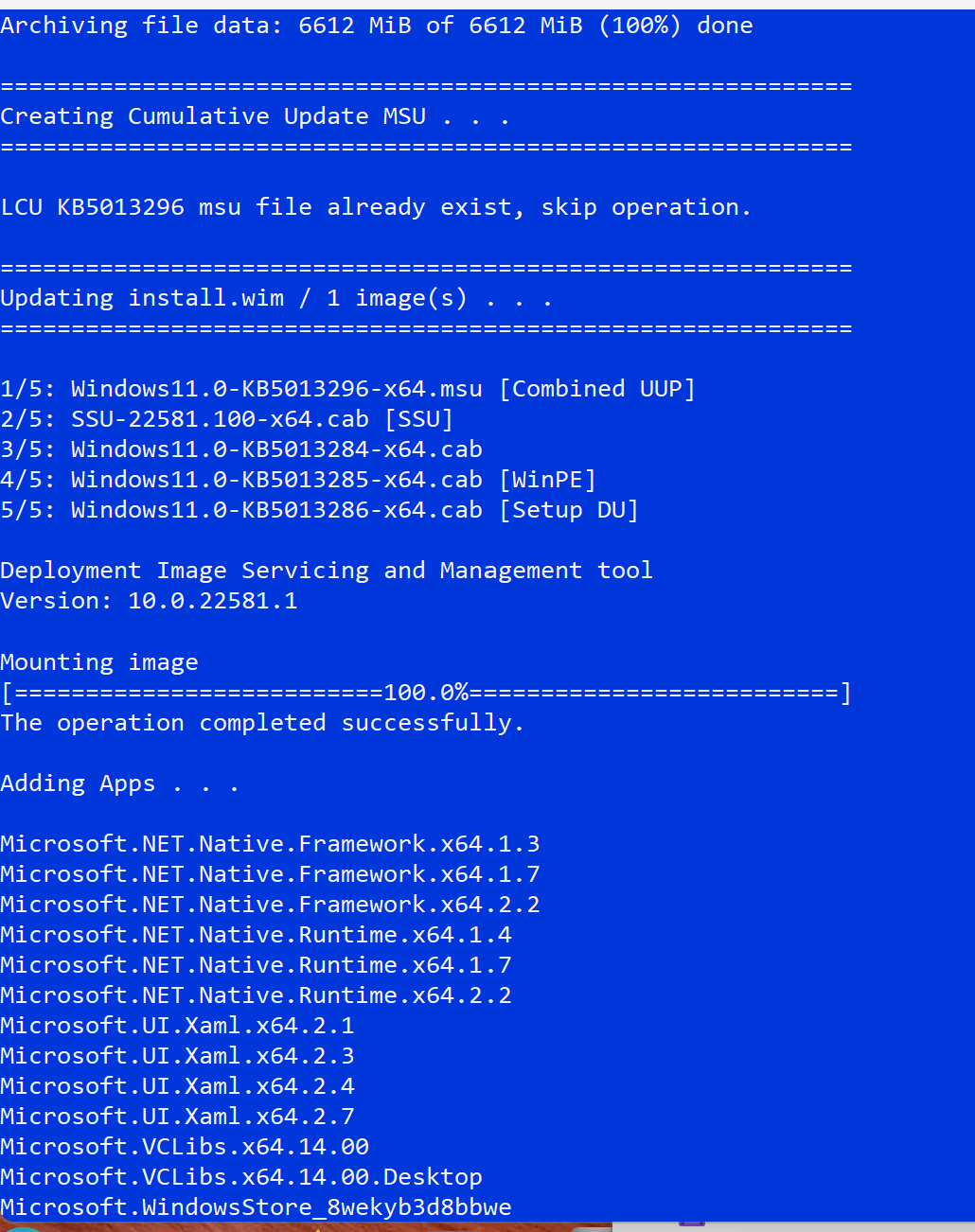

    I see in the ConvertConfig those 2 parameters are set to 0 as a default, but it is not finding any of the Apps to add.
    Still not clear where those Apps are downloaded by W.U.
    Apparently, they are not in SoftwareDistribution folder.
    Perhaps on next Build after W.U. downloads I will search the whole C: volume to see if I can find the files anywhere. πŸ€·β€β™‚οΈ
    What about the AddUpdates, should that be set to 1?

    Yes thanks. I just saw that adding the updates for 22581.100 and 22581.200.
    Still does not get the Apps unless the files are in the folder.
    Tried the other Apps options 1,2,3 they seem to be just a subset of AppsLevel set to 0 which is the default and includes 57 plus Apps.
    Looks like it is still work in progress. πŸ˜‰
