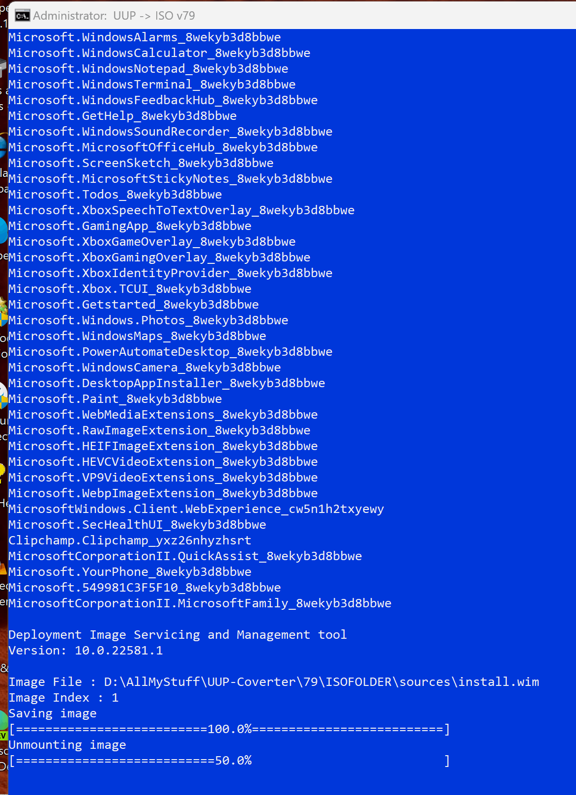

    Hi Johnny,
    I'm trying with v79 of the converter, and it is adding all these.
    Sure, seems to take a long time. We'll see what happens.
    I see SecHealthUI added. that is a good sign. ๐Ÿ˜Š
    The resulting ISO worked fine, has Settings and all the needed Apps.

    Hi Johnny,
    All the needed windows Apps are installed including SecHealthUI 22581 on this clean install with the ISO just Built as you suggested.

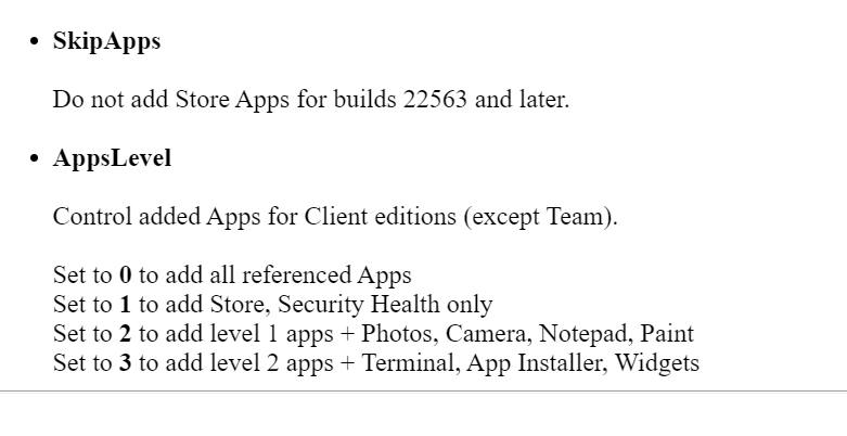

    I haven't had a chance to play with 79 fully, but this is from the ReadMe.html file from "uup-converter-wimlib-79" for config settings:
    So not sure how this is all suppose to work. Yes there is going to be a time delay to create these Nickel ISO's down the road. Thanks MS.
