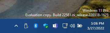

    Here is a clean install on 22581.1 on a red zone box, then updated with W.U to 22581.100.
    All Apps are there and all updated fine.
    Everything worked correctly using the ISO you suggested. 👍😊
