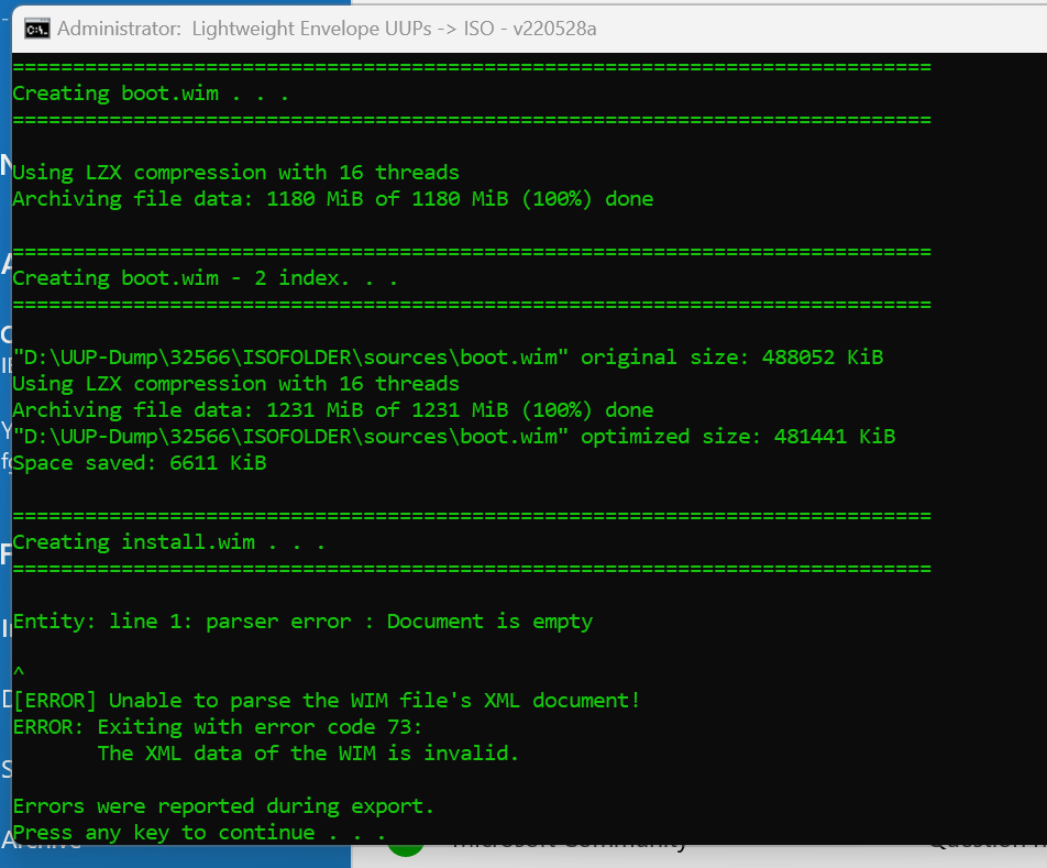

    I just tried the script and it failed:
    Weird, try again, it worked for me.

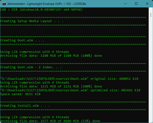

    edit:
    Look, it is working on a new download
    These things are never reliable depending on when you try they get different results.

    I had/have no problems with this one either, see edit above.
    edit: just finished, here's the new one

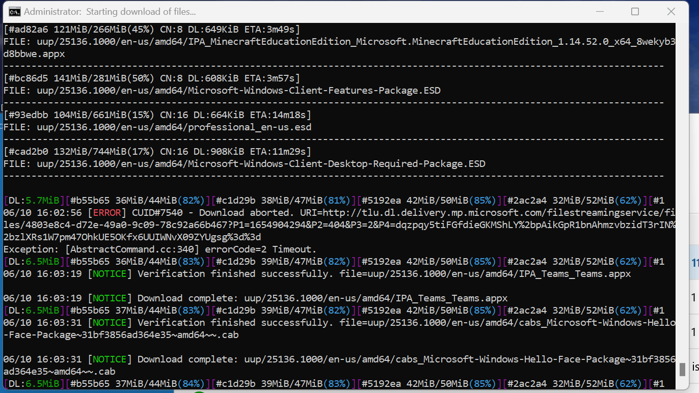

    Trying once more, after deleting everything...
    2022-06-10T23:10:06+00:00
    IDK what to tell you, maybe your internet connection is unreliable. 🤷‍♂️
