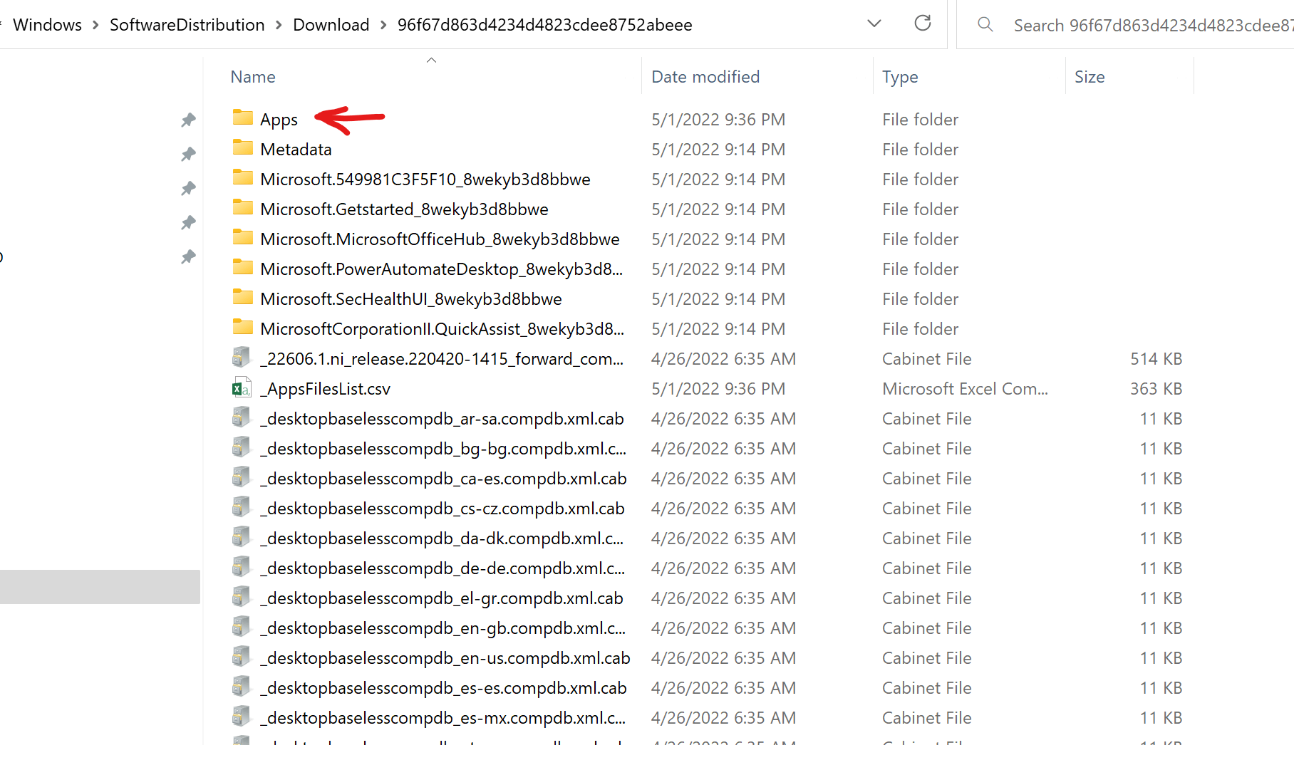

    Yes, we are screwed on which way to go right now. I put up another FBH regarding the loop: Hehe, never mind, see you already upvoted, I got yours as well.
    https://aka.ms/AAgugg3
    Regards,
    I just saw a comment on the FBH report saying that pausing the update and then resuming it gets rid of the loop.
    We can try that too to see if it does the trick. 🙃
    Hi fg,
    I did try pause the updates with 22616, rebooted then resumed. It did get rid of the loop. That trick is working. Wasn't sure if the reboot was necessary, will try on one of the other vm's. Not thinking clearly tonight 🤣
    Regards,

    Since I kept getting errors on uupdump download for 22616 x64 en-us Pro, I ended up trying the other method.
    I downloaded separately the "Any Laguage" Microsoft Store Inbox Apps to get the update version of the Apps and then merged the downloaded files with the SoftwareDistribution\Download uup files that came down with W.U.
    I then used the converter 79f to build the ISO with the Apps just downloaded and merged and made a new ISO.
    I will try another clean install and check if SecHealthUI is at the correct 22616 level.
    The 1st ISO I built was with the older apps folder from 22610 and SecHealthUI showed the old level accordingly as I expected.
    With last ISO I made as described above the level of the App is now matching the Build 22616.
    The regular download from uupdump kept failing all the way to 11:30PM Pacific time, maybe it will work tomorrow, but for now I got all I needed. 🙃
    Still, it is a pain in the neck to make it, but you can see that many Apps are at 22616 level with the ISO I built.
