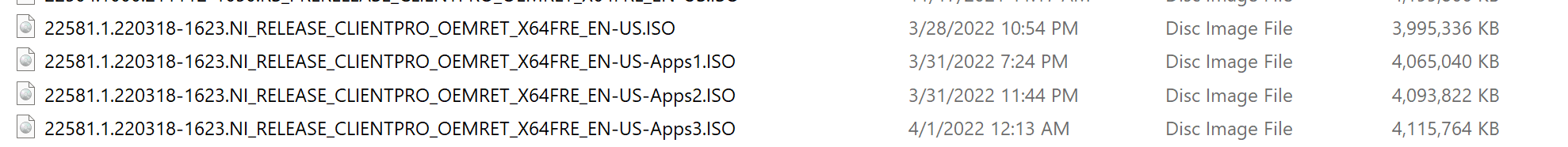

    See below the different size of the ISO for Windows 11 Pro en-us.
    The first is without Apps, the other three:
    AppsLevel 1 with 15 added Apps
    AppsLevel 2 with 19 added Apps
    AppsLevel 3 with 22 added Apps
    AppsLevel 0 with 58 added Apps
    The lists of the Apps included with each level are on my previous posts.

    If I do a clean install with the ISO built with AppsLevel = 1.
    The MS Store does not find anything to update except for itself.
    You still have to download many of the basic Apps manually from the MS Store including Mail, Notepad, FeedBackHub or anything else that is commonly used.
    A different story if the same ISO is used for upgrading, in that case the Apps from previous build are there and may be updated by MS Store when checking for updates.
    With the ISO built with AppsLevel = 0, everything is there on a clean install including Widgets which I think needs one of the Apps not included in AppsLevel = 1.
    Probably the MicrosoftWindows.Client.WebExperience which cannot be installed from MS Store.
