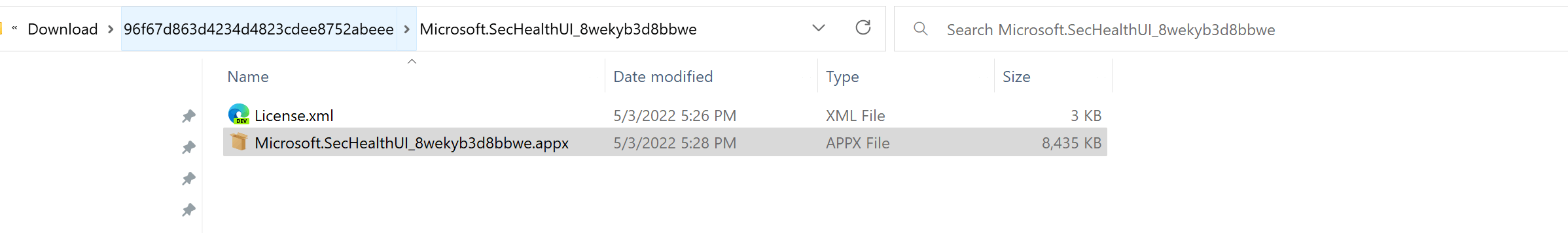

Microsoft.SecHealthUI Microsoft.SecHealthUI_1000.22557.1.0_x64__8wekyb3d8bbwe

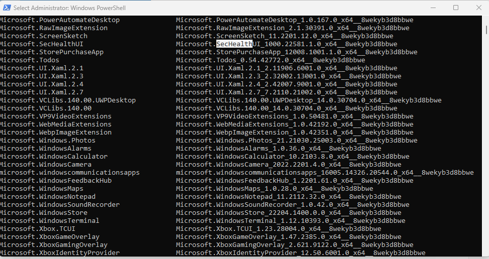

    Get-AppxPackage -allusers | Select Name, PackageFullName
    MS Store was not in the Applications folder till I installed it.
    Still no way to get Microsoft.SecHealthUI of any version.
    That makes the whole exercise useless.
    See last comment of Rafael Rivera in the link below, hopefully they will fix the scripts to create a usable ISO. 🤞
