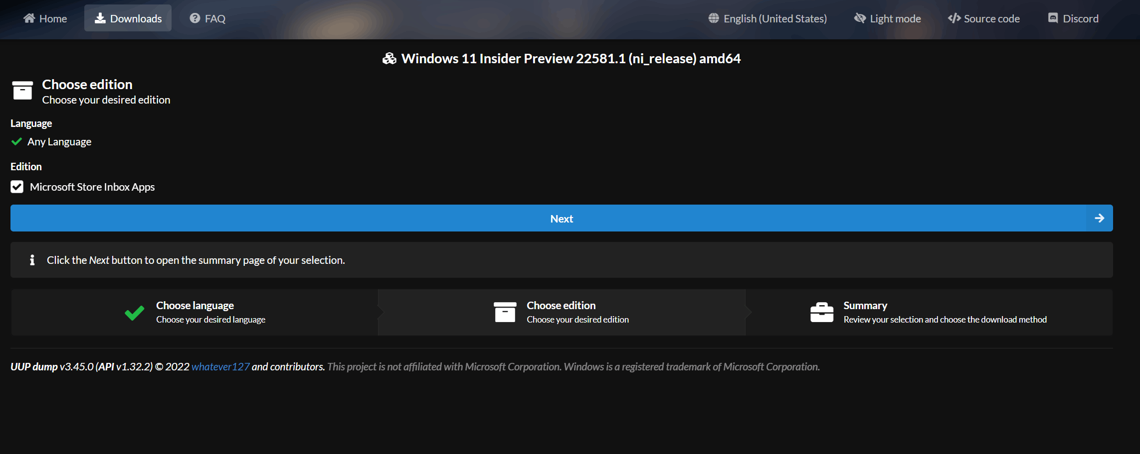

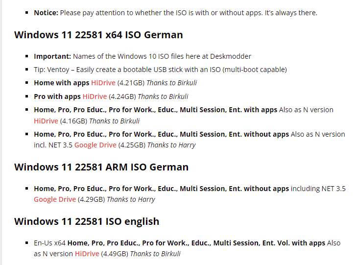

I created all 5 installation ISO files for all 5 Builds, but only 22557 contains all the system Apps required for a full clean install, the other 4 are missing all the basic Windows and System Apps needed for a functional system. Also, the App required for opening Windows Security (Microsoft.SecHeatlthUI) is missing, all this makes the resulting system unusable.
