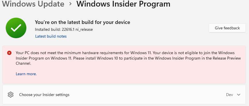

    Edit:
    Tried again upgrade with W.U. from 22610 to 22616 on a red zone Legacy Bios box, I verified that I can get the same result, by leaving the appraiser.dll alone in C:$Windows.~BT\sources and instead just replacing AppraiserRes.dll with an empty one made as you suggested.

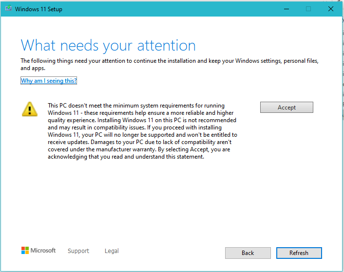

    After that I just hit Fix and the operation resumes with the message below.
    I can just close it or wait till it is closes automatically after 2 minutes, the download and upgrade proceed normally.

    And this message is from 19044.1682 R.P. to 22616.1 With ISO on a red zone box:

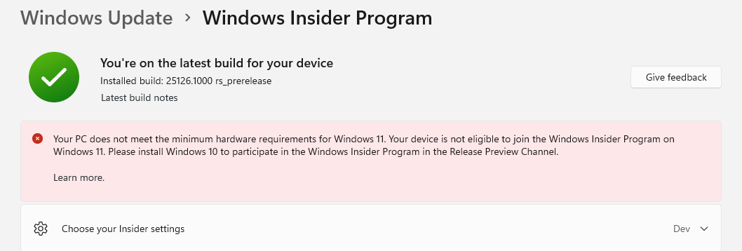

    Again with 25126. 🀣
