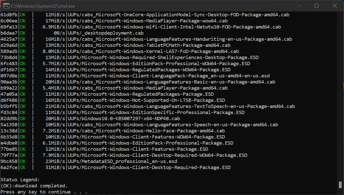

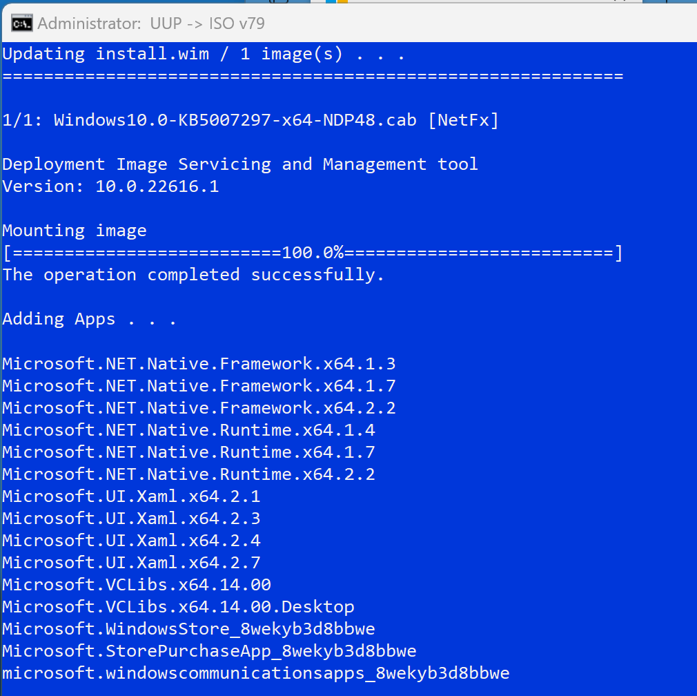

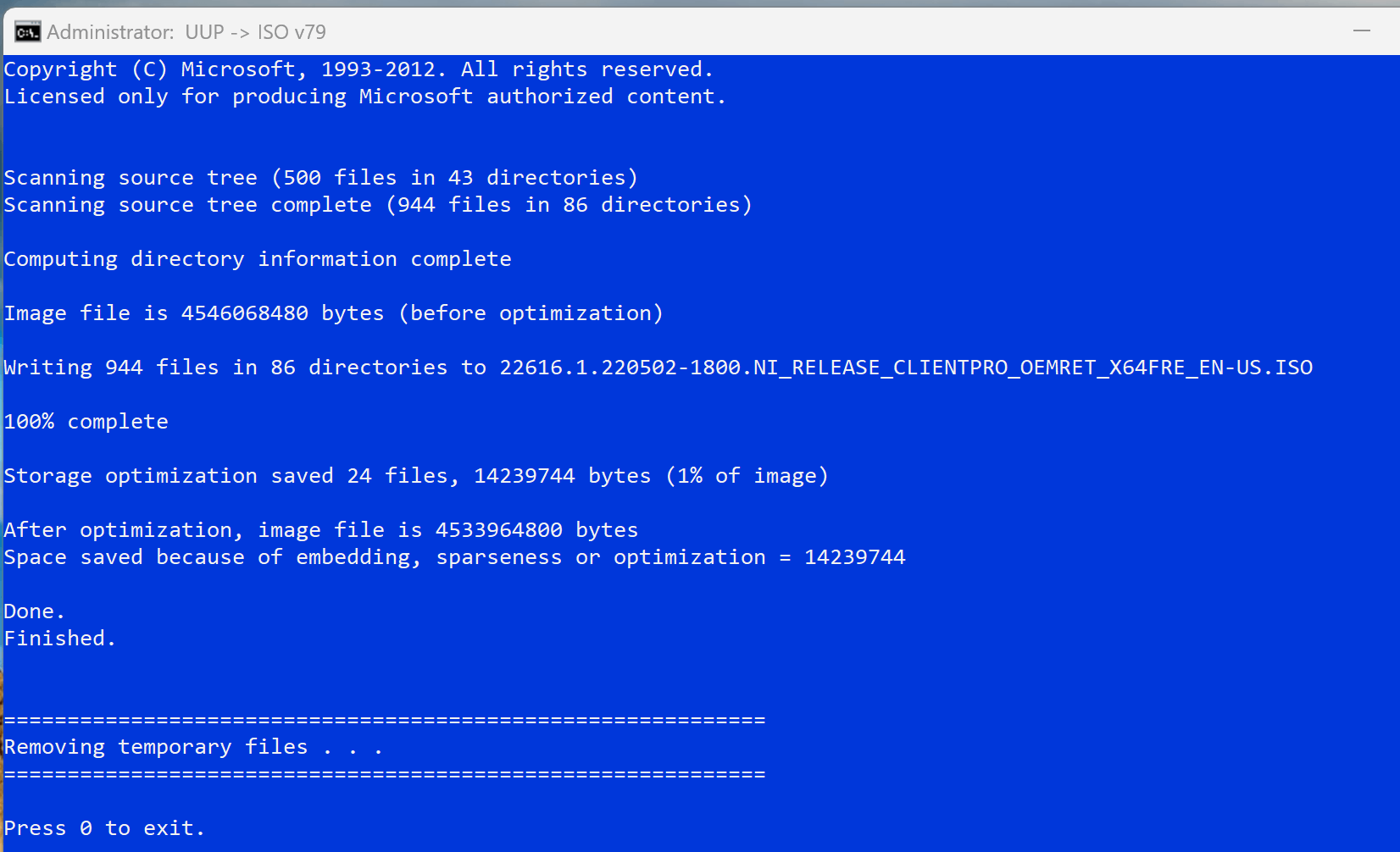

    Hi Johnny,
    Here are the 2 ISO files, top one just made from the uupdump download that finally worked.
    The second one made yesterday from SoftwareDistribution after merging in the downloaded "Any Laguage" Microsoft Store Inbox Apps.
    Not much difference in size, both ISO files have everything that is needed. πŸ˜‰
    Painful process in both cases compared to the way it was done before these Nickel Builds. 😜

    Hi Johnny,
    Last retry attempt at 11:00 AM Pacific time, got passed the download error, it is building the ISO now. 🀞
    After so many retries, it is finally done. πŸ˜‰

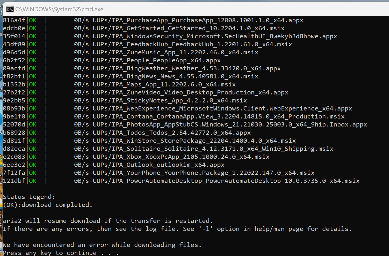

    2022-05-06T17:49:00+00:00
    Tried again today 5/6/2022 at 10:45 AM and failed again. πŸ€·β€β™‚οΈ
    Found this file with the error showing below.
    I then restarted the download at 11:00 AM and it seems to be going further now.
    We'll see if it completes this time. 🀞
    Exception: [AbstractCommand.cc:368] errorCode=1 URI=https://uupdump.sf.tlu.dl.delivery.mp.microsoft.com/filestreamingservice/files/9ffb4662-084c-4501-a586-fd280b343a7f?P1=1651859323&P2=404&P3=2&P4=iXspNfLqt%2flJ4C6tYFLM%2bryt1UKVdQSoxLBN%2b2%2f7Wr03QSBEwlTYHUSYI6OXLhTyhw1LJky2Fiodv1BdnU8GkA%3d%3d -> [AbstractCommand.cc:312] errorCode=1 Network problem has occurred. cause:A connection attempt failed because the connected party did not properly respond after a period of time, or established connection failed because connected host has failed to respond. 2022-05-06 10:39:19.648560 [INFO] [HttpConnection.cc:163] CUID#999 - Response received: HTTP/1.1 200 OK Cache-Control: public, max-age=17280000 Content-Length: 9938 Content-Type: application/octet-stream Last-Modified: Sat, 19 Mar 2022 15:22:11 GMT Accept-Ranges: bytes ETag: "hwr9LfzL5UVXsfcxS7BYvtQyVH0=" Server: Microsoft-IIS/10.0 X-Cache: TCP_HIT X-AspNetMvc-Version: 5.2 MS-CorrelationId: 4838005f-f876-48f1-a45d-f672b6cb8fe3 MS-RequestId: 213cee37-e800-4367-985b-118e8dfc08ac MS-CV: Yf6yRORFAEemMP4Q.1.1.34.181.1.3.1.1.1.0 X-AspNet-Version: 4.0.30319 X-Powered-By: ASP.NET X-Powered-By: ARR/3.0 X-Powered-By: ASP.NET X-CID: 7 X-CCC: US X-CID: 7 X-CCC: US X-Azure-Ref-OriginShield: Ref A: 0F2687D7E1DF4586B75FF74FE7E991C9 Ref B: SN1EDGE1906 Ref C: 2022-05-04T20:07:34Z X-MSEdge-Ref: Ref A: CE505B87C73445D8AE8288F0B211D37A Ref B: LAX311000112047 Ref C: 2022-05-06T17:39:20Z Date: Fri, 06 May 2022 17:39:19 GMT
